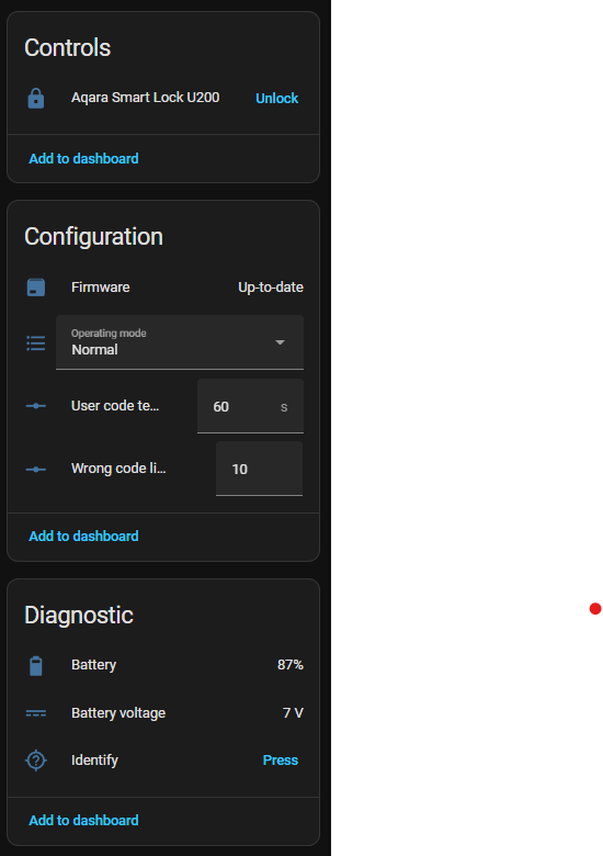

I’ve been testing the Aqara Smart Lock U200 with Home Assistant via Matter, and while the hardware is genuinely solid and the price point is attractive, the Matter implementation is unfortunately incomplete. Based on real‑world behavior and a full Matter diagnostic dump, several core features of the Door Lock cluster are simply not implemented correctly.
1. PIN codes via Matter do not sync to the keypad
Home Assistant successfully writes credentials into the Matter Door Lock cluster, and maybe the U200 stores them internally. However, I think the motor unit does not reliably push these credentials to the external keypad over Bluetooth. Result:
  • HA shows the PIN as “set”
  • The keypad never accepts it
  • No error is reported
Creating the same PIN in the Aqara app works instantly, which confirms the hardware is fine — the issue could be in Aqara’s Matter stack or somewhere else. I don't know exactly and the longer I am investigating the more unclear it is for me.
The U200 does not expose any of the required Matter events like:
  • unlock source
  • user index
  • credential type
  • PIN usage events
  • failed attempt events
  • programming events
That means there is no way for HA to know who unlocked the door.
This is why Home Assistant always shows the attribute changed_by: unspecified when looking into the HA dev-tools.
This is what matter server says:
2026-07-05 22:08:02.686 INFO ... Received event doorLock.lockOperation ... lockOperationType: 0 operationSource: 0 userIndex: null ...
The lock is not sending any ClientID oder attributes.
3. Thread connectivity is fine
The Thread cluster reports stable routing and normal behavior. This confirms the issue is not related to Thread or the border router. I am using a ZBT-2 with nothing else than a Thread-Network.
Conclusion
The Aqara U200 is mechanically okay and very affordable, but its Matter implementation is objectively incomplete. PIN management via Matter is not working, and the lock does not expose the required door Lock events that Home Assistant automations would depend on. Even on the latest firmware, the device behaves like a partially implemented prototype rather than a fully compliant Matter lock. Which is even more frustrating since this is one of Aqaras "works with home assistant" certified locks.
For anyone relying on Matter for PIN management or automation, the U200 is currently not suitable. The Aqara app works, but Matter does not.
Or am I missing something here? Since I have no Apple border router here I can't test this Apple first and then link the whole subset to home assistant.
It might be a bug on HA code management; codes do work well via Apple Home (Matter).
