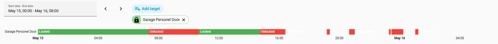

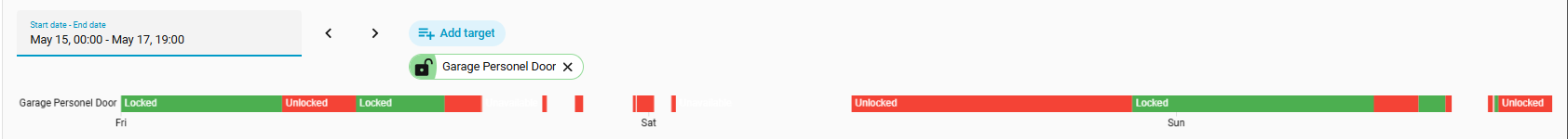

I’ve suddenly started seeing long periods of unavailability with my U300. I’m away from home so can’t check in the Aqara app. I was previously really reliable.
It’s on the latest version of it’s firmware:
Anyone know a possible cause of the issues? I haven’t found anything useful online as yet.
Do you have other thread devices on the network for meshing? I stopped having a similar issue with my P2 door sensor when using only just the one device soon as I added the lock.
No, this is the only device. It's not far from the hub though. I never had this issue until the last week or so (months of solid connectivity).
I recommend to invest in at least one other thread based device for the mesh to stabilize a little when it comes to making sure.
If you need, take out the batteries and put them back in to power cycle the lock just to refresh things and see if the issue persists.
Yeah ok, I'll see what is around that I could potentially buy. The thing is, most are end devices and not routers right? EDIT: I'll go and grab an IKEA Matter plug I think, cheap and easy test.
The connectivity seems to be fine for many hours, then long periods of unavailability.
