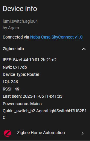

The EU version of the quirk works just fine with the US model - you only need to change the device id.
Any chance you can explain how to do this?
It looks like this is working for me!
Take the file from the link below and put it in a folder called zha_quirks so it is at the path below. Remove the device and add it again. It should show up in the device info like the image attached
/homeassistant/zha_quirks/switch_h2.py
I get something like this I can turn into a button:
“Office light switch 4 Single event was fired
2:56:15 PM - 31 seconds ago”
