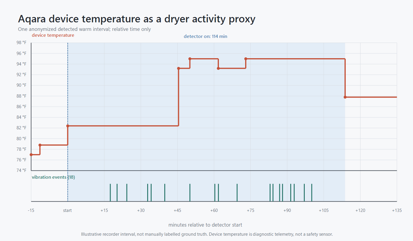

The useful signal turned out to be an entity I had mostly ignored:
sensor.aqara_dryer_device_temperature.
This is the sensor’s internal device temperature, not a calibrated measurement of
the dryer’s air or clothes. Because the sensor is attached to the metal cabinet,
however, heat from a running dryer conducts into it. In my setup it rises by about
10 degrees F during a cycle. The reading is coarse, in roughly 1 degree C buckets,
and only reports when it changes, but it is much more stable than the vibration
events.
The important part was to avoid absolute temperature thresholds. Room temperature
changes, and the cabinet can remain warm for hours after a load finishes. Instead,
I use a small state machine:
  1. Start when a new reading rises by at least 2 degrees C, either in one jump or
    across two or more consecutive rises within five minutes.
  2. While running, remember the highest temperature seen.
  3. Finish when the reading falls at least 2 degrees C below that peak.
That makes both edges relative to the sensor’s own recent behavior. It does not
matter whether the room started warm or cool.
There is a real latency tradeoff. In my installation, the rise appears a few
minutes after startup, while cabinet cooling means binary_sensor.dryer_running
commonly remains on for roughly 30-45 minutes after the drum actually stops. That
is too slow for precise cycle timing, but it is the most reliable proxy I have
found for whether the dryer should still be treated as unavailable.
My most useful automation consumes this as a gate: a separate “washer is done and
dryer is available” nag can fire only when the washer is finished and this binary
sensor is off. That washer-done logic is much simpler, so I am keeping this post
focused on deriving the dryer state.

My sensor reports in 1 degree C buckets, so 2 degrees C means two buckets. A finer
or noisier sensor may need different numbers and timing.
What the recorder showed
After the final relative-rise version was installed, I replayed 51 days of Home
Assistant recorder data:
  • 110 complete detected warm intervals
  • every start followed a newly reported rise of at least 2 degrees C
  • every stop followed a drop of at least 2 degrees C from the remembered peak
  • no interval was shorter than 34 minutes, so there was no short on/off chatter
  • 97 of 110 had either laundry-room motion around the interval or a washer
    completion in the preceding six hours
  • only 71 of 110 had even one vibration event, illustrating why vibration was a
    poor required signal here
Those are not 110 manually labelled dryer loads, so this is field evidence rather
than a measured false-positive rate. Seven intervals lasted more than three hours;
back-to-back loads or slow cabinet cooling can merge into one long “running”
interval. This detects a heating stretch, not exact drum rotation.
