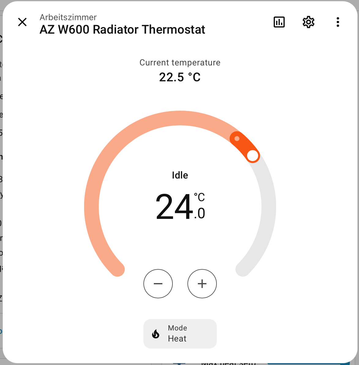

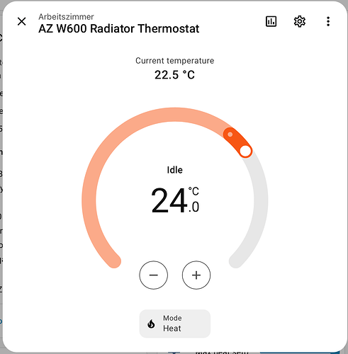

I’ve started playing around with HA and Aqara devices. The quirk I came up with allows to set the temperature as shown in the screenshots:
You can find the quirk here: homeassistant/custom_zha_quirks/aqara_w600_trv.py · develop · Joerg Hampel / My Personal HA Setup · GitLab

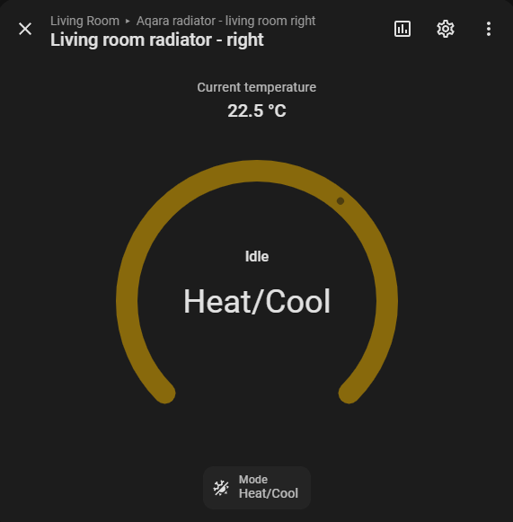

Mine is stuck in heat/cool mode and the slider is not working. I am really new to this will this quirk fix my issue as well as giving me the slider?
