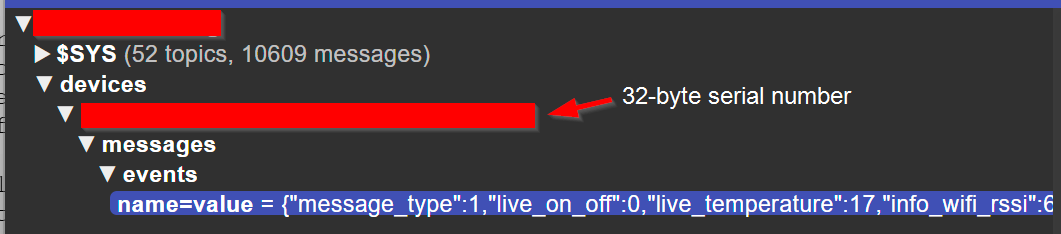

  1. Connect an MQTT Explorer to both brokers, turn on and off the shower for a few seconds, and ensure you see the shower’s messages. On the second broker, you should see the topic “devices/{sn}/messages/events” where {sn} is your shower’s serial number:
Copy the serial number.
On the primary broker, you should see the topic “aqualisa/devices/{sn}/messages/events”.
