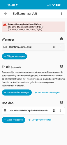

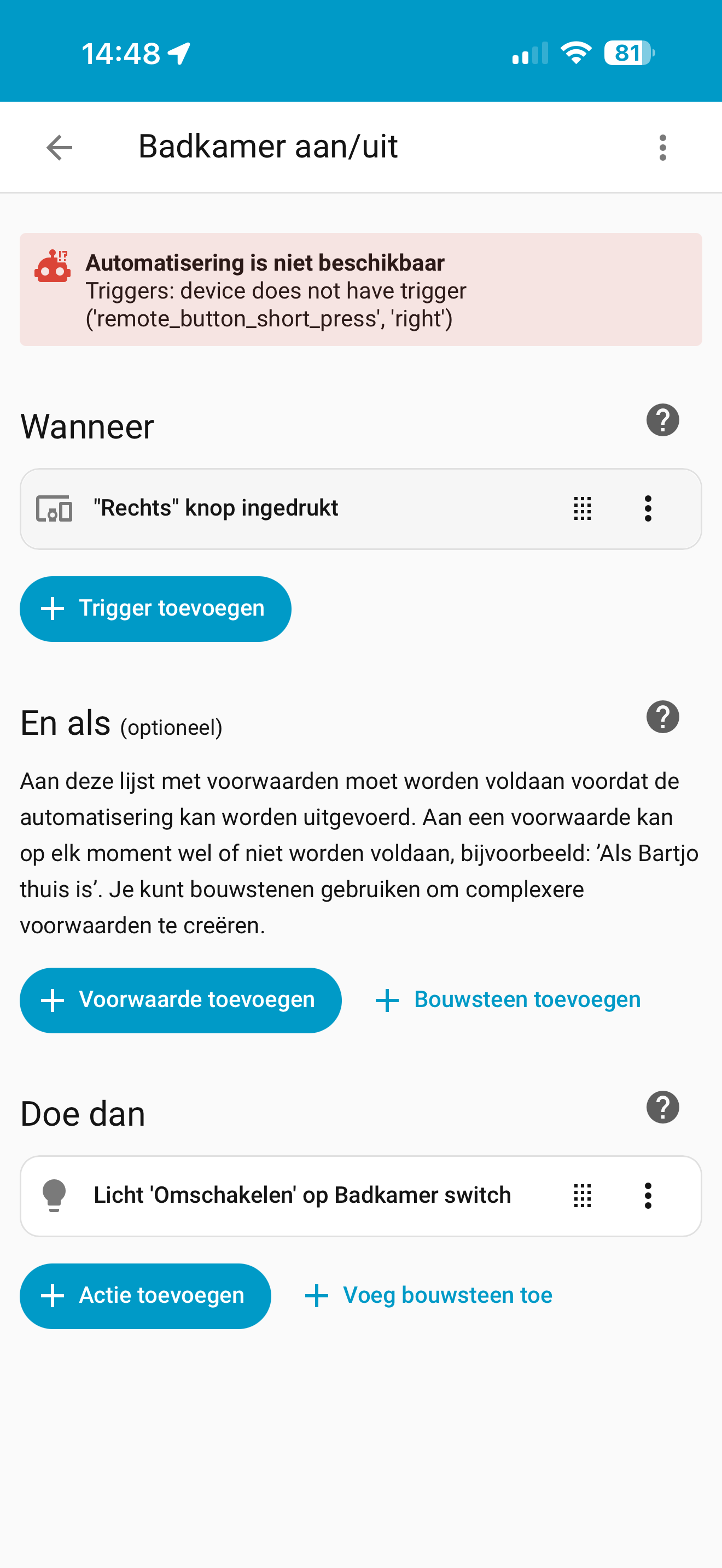

So I have a Aquara Remote Switch with two rockers. Setup is pretty easy. I just add it to the Zigbee automation. After successfull install I make two automations. One for the left button: when button pressed turn on a light and the same for the right button for a different light. Works like a charm…
But then when for what ever reason the Zigbee dongle is not available for a bit because of restart or a shorter or longer of the Sonoff Zigbee 3.0 USB Dongle Pus V2 afterwards the remonte switch is still connected but lost its available triggers…
I have been looking for ways to “fix” that in an easy way like using the “reconfigure device” option. But that does not work.
I have to remove the switch and then re add. Then I have no issues setting it up again. Works fine the until the next failing of the Zigbee dongle.
Update: Just happened again. I just ran some Home Assistant updates. After the updates the triggers are gone again…

Don’t think that is the solution. I actually have two of those. They are new. Both have the same issue. Does seem more of a software issue…
