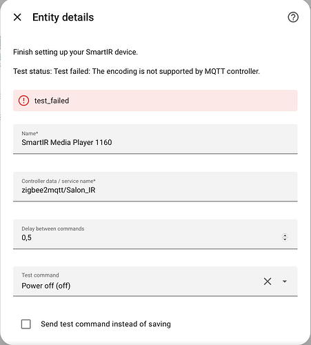

Hello. Thank you for this new integration that seems to be very fancy and practical!!
I am quite new in home assistant and I am trying to control a Logitech Z906 media player with a UFO-R11 Zigbee IR emitter connected via M2QTT in Home Assistant
I have tried to learn IR commands and send IR commands with the IR emitter from Home Assistant, which is working fine. However I am not able to make your integration of AR Smart IR to work.
I send enclosed pictures of the IR emitter configuration under Zigbee and also the Z906 configuration under AR Smart IR.
¿can you please help me to make this work? Maybe I am doing something wrong in the configuration.
Thank you in advance for your work and for your help!!
Hi
:warning: AR Smart IR does NOT use raw learned codes directly from Home Assistant
It uses pre-defined JSON device files (SmartIR-style)
I’m in the process of building a JSON file creator that will allow users to generate and upload their own device profiles, helping to continuously expand the database.
Thank you for your reply. I know that the AR Smart IR uses condes from the JSON database, and I confirm that Logitech Z906 is one of the devices included in the database (code 1160). When I spoke about the correct RAW codes emitting, I just wanted to confirm that my IR emitter was correctly connected to Home Assistant.
However, I am not able to make the AR Smart IR integration to send IR messages to my Z906. I would say I did something wrong when configuring the AR Smart IR but I don’t know what can be wrong. This is why I was asking for help :wink:

Hello. I updated AR Smart IR to the new version. Deleted the previously configured Z906 entity and created a new one. In the last step, I selected “Send test command instead of saving”, but unfortunately it is not working. I get message “test_failed” after pressing “Send”. See picture enclosed
