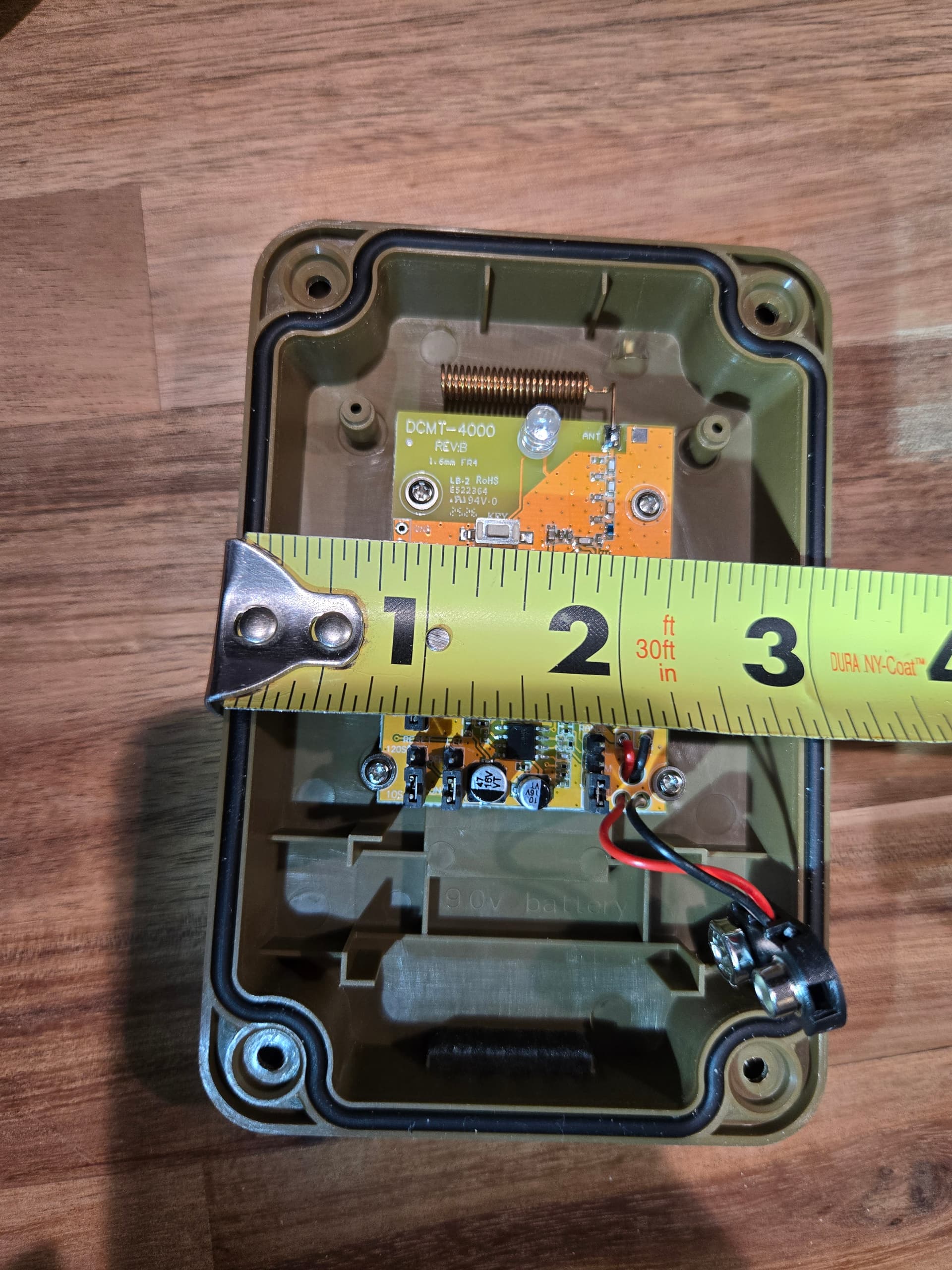

I just saw the inside of the sensor in the one video. The PCB is small. I guess I could just remove the board and connect a 9v battery. Does that sound reasonable?

I think the fisheye on the front of it expands the view of the sensor. But, I am just guessing.
Might want to do it in a way to put that back on. I am thinking turned sideways, cut off the top and/or bottom as needed and put new screw holes outside of the PCB.

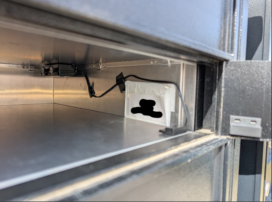

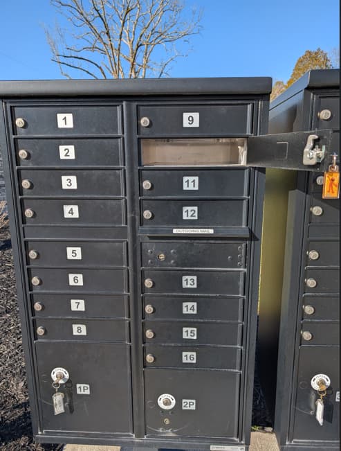

I just setup mine today. Unfortunately, the mailbox is built like a vault! I don’t have the option of installing anything outside the mailboxes. I’m amazed that I get a signal at all! According to the Yolink app the signal strength is -76 dBm. It says it is “strong” but it’s actually flakey. Sometimes it works sometimes it doesn’t. I might try placing the hub outside my house on Wi-fi and see if that helps.
Ahhh…Yep. That’s going to make it hard to get consistent results. Mine is just a standalone mailbox at the end of my driveway. Everything is completely hidden. Even when you open the door, you can’t see anything. I mounted the reed sensor on the bottom lip of the door on the back side so when you open the door, it moves up and under the bottom of the mailbox and trips the wired end of the sensor which is mounted on the bottom of the mailbox.
I finally got this working in the “bank vault” of a mailbox using a YoLink LoRa Smart Outdoor Contact Sensor & Hub Starter Kit. Specs say 1/4 mile range. The signal strength was flaky until I moved the hub outside in direct line of site with the mailbox. Now it works 99% of the time IF the temperature is above 25 degrees.

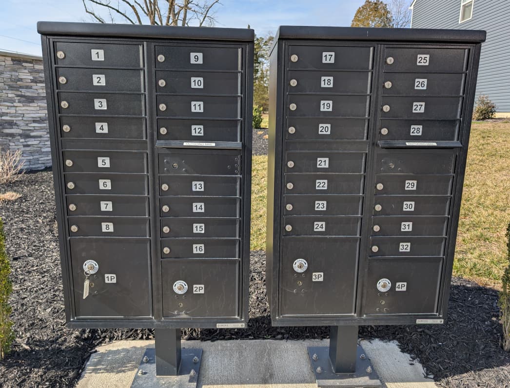

I was looking at doing this with a Zooz ZSE41 800LR contact sensor and the HA Connect ZWA-2. Our neighborhood has a community cluster box, which is about 320 feet from our house. Theoretically a 1300 ft (line of sight) range should do the trick.
