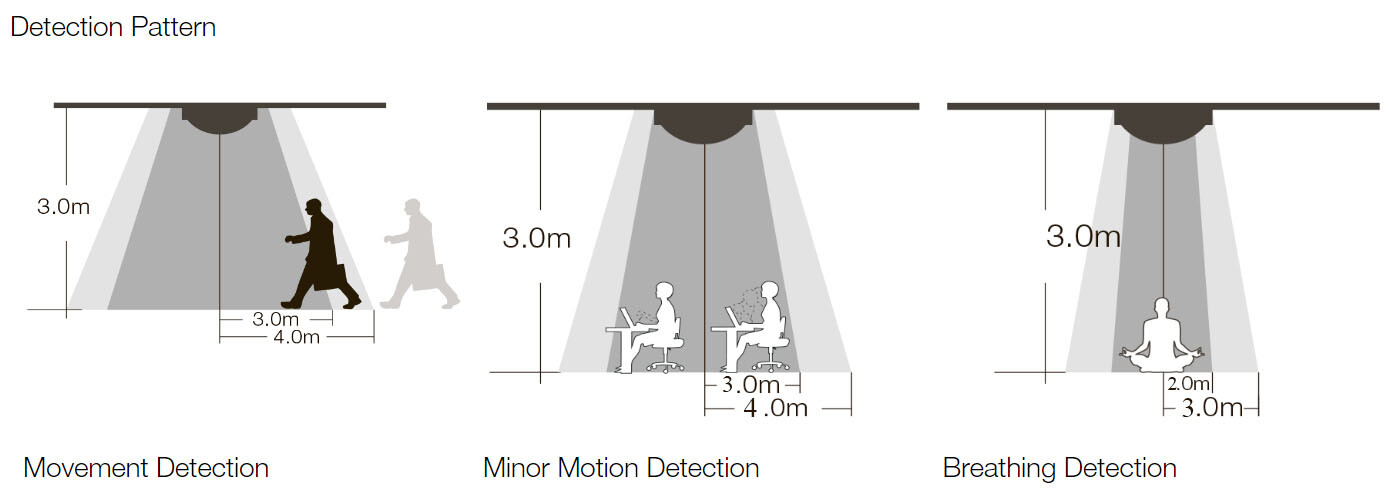

All microwave presence detection sensors have very specific ranges for micro movement detection. The Athom PS02C3 does not even mention it can do this. How far away from it are you when sitting still?
e.g. this is for a random sensor I have never used:
