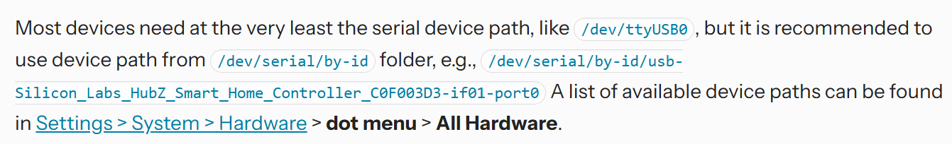

The following is from the ZHA docs, but it applies equally well to anything which requires a USB device to communicate
You might not necessarily run into issues if the devices set assigned the same path when you plug them back in, but at the very least take note of what paths they are using before unplugging anything.
