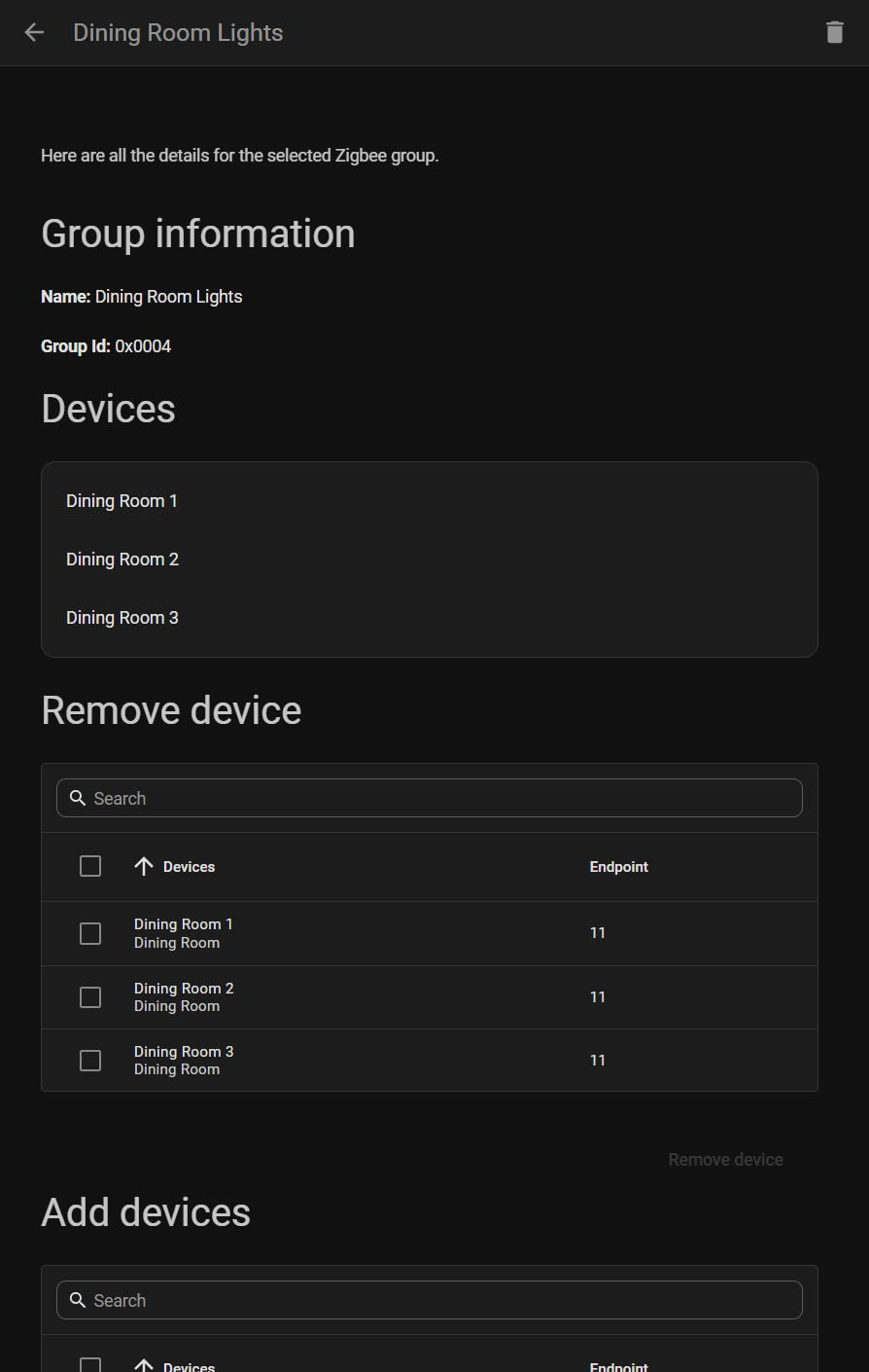

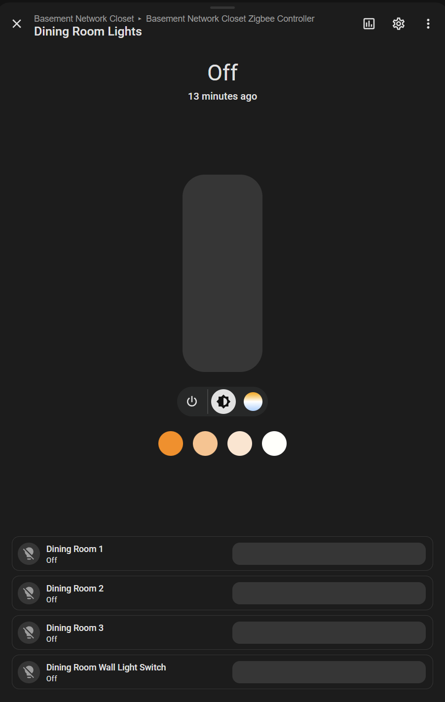

Ok… I’m actually fine with Zigbee groups if they look like this in Home Assistant now:
I don’t think this was the case until 2026.4. I don’t remember being able to go into a Zigbee group to see its members like a regular Home Assistant Group until just now.
But I still don’t like how you create the group through this awkward menu with very basic UI:
It’d be neat if Home Assistant could do this for you using the Group helper integration in a way that you didn’t have to manage the groups themselves by hand.
