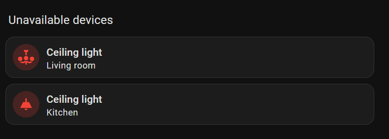

Nowadays, with entities assigned to areas, you should be able to use just “ceiling lamp” and extract the area name from the entity to show on a tile, right?

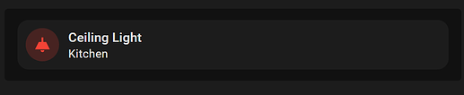

In the end, I just want something like this:
Like this with the Mushroom option I mentioned
type: custom:mushroom-template-card
primary: Ceiling Light
icon: mdi:ceiling-light
entity: switch.kitchen_lights
icon_color: "{{ 'red' if is_state(config.entity, 'on') else 'grey' }}"
secondary: "{{ device_attr((config.entity), 'area_id') | capitalize }}"
tap_action:
action: toggle
