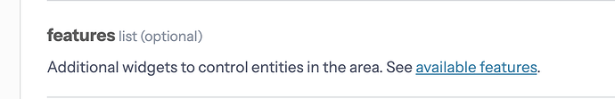

The documentation says it supports features

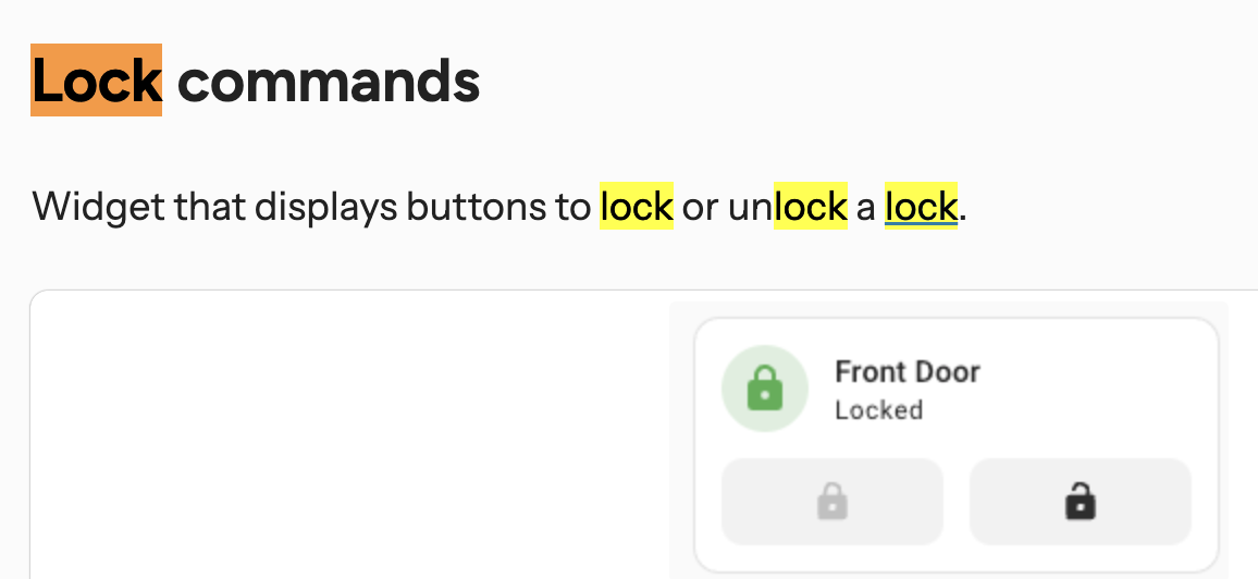

which takes you to Features for dashboard cards - Home Assistant
This has the lock, and I’ve configured this item and proven it works, so why doesn’t it appear on the area card?
https://www.home-assistant.io/dashboards/area
* takes you to
https://www.home-assistant.io/dashboards/features

I have tried overriding the features configuration from area-controls to
features:
- type: lock-commands
I can see it accept the syntax (it's happy with lock-commands) but then nothing shows...

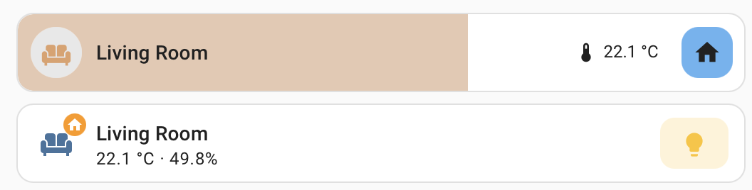

With the latest update it looks like area cards have added a lot of functionality I’m relying on Bubble Card for but I too am missing some flexibility in adding features.
On top I have the Bubble card and then below the default area card. I’m hoping that a light slider will be added in place of the button here. I’m working around that by having the area card navigation trigger a popup and then having a bubble card slider for the lights.
Also, within the card features It would be good if we can add regular icon buttons to trigger other actions (sub buttons in Bubble Card).
Other than that I’m really happy with this latest update to area cards.
