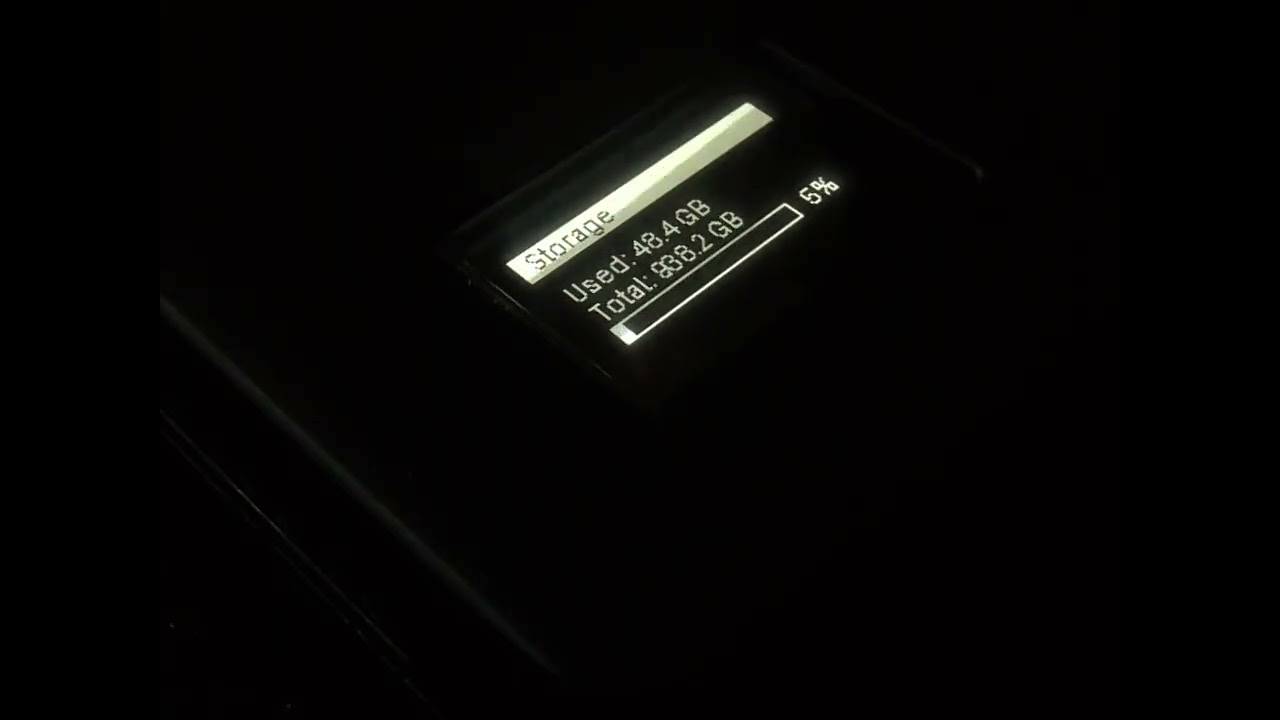

Display Screens
  • :desktop_computer: Logo Screen
  • :one_o_clock: Clock Screen - Digital 7-segment style time display with date
  • :laptop: CPU Screen - Usage percentage and temperature with progress bars
  • :brain: RAM Screen - Memory usage with detailed statistics
  • :floppy_disk: Storage Screen - Disk space usage and availability
  • :thermometer: Temperature Screen - Large temperature display with status indicator
  • :globe_with_meridians: IP Screen - Network IP address and connection status
  • :mobile_phone: QR Code Screen - Scannable QR code for quick HA access
  • :house: HA Status Screen - Updates available and last backup date
