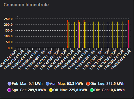

I’m trying to get a chart with a bimonthly bar chart with energy power consuption starting from february-march. What I want is a 6 bar chart and I used this code:

But what I get is the following:
How to get what I want?
