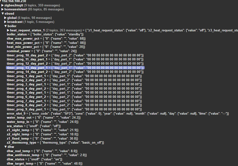

Firstly, many thanks for your work. I managed to connect to my boiler and see some basic data. I think i have unusual boiler - HS 24 Premium - and I’m getting quite many unidentified messages. I’m running similar setup as @rufusz so only boiler and shield are on the bus.
Can you point me in the correct direction as to decoding some of the messages?
My goal is to have a possibility to 1. turn on and off heating mode based on HA triggers 2. Simulate external temperature sensor as to activate slope mode of the heating temperature.
Here is result of ebustcl info:

and grab result all
# docker exec -it addon_2ad9b828_ebusd ebusctl grab result all
