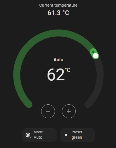

I’m now just one datapoint short of integrating our Ariston Nuos Split water heater in HA and that is the one that allows me to read and set the program type: Green, Comfort, Fast. I also do not yet know the codes for Holiday and Boost but I can live with that.

In HA I get it like this (via mqtt configuration):

I´m also still searching for this “program type: Green, Comfort, Fast” and also for the silent mode.
I checked all 65535 possible addresses with “hex 7c 2000 02 nnnn”. From 275 I got a value other then 0100. None of those seem to reflect program type, although I found address d140 (actually 40d1) that increases every time I change the program type in the app.
Oh, wow. Thats interesting. Then I do´nt need to search in this direction furthermore. Thanks! Some of the values I posted earlier just seem to be some counters, increasing every time the HP runs (41af and 42af) others seem to count the seconds, the HP runs (40af and 44af). But nothing really interesting…
Turned out that I made a mistake in comparing values. I found addres 89de (to be entered as de89 in the query: hex 7c 2000 02 de89) for the program: 0=green; 1=comfort; 2=fast.
The program can be set by hex 7c 2020 03 de89 nn where nn is 00, 01 or 02 for green, comfort and fast.

Great find. This indeed shows the current temperature of my boiler. Thanks, you are the hero of the week now :grinning:

I can confirm that de89 sets the the green, comfort and fast mode for my devices as well.
With your output list I could easily find out the silent mode setting: :grinning:

Finally managed to get the control for the Ariston Nuos Split in HA. I had to use a climate entity instead of a water-heater entity as the water-heater entity does not have the preset control.
The target temperature cannot be set in the control as the target temperature is a computed value. This is also valid for the Ariston App. In there in the Program (auto) mode the target temperature cannot be set and in manual (heat) mode adjusting the target temperature sets the comfort temperature.
It could be implemented with an automation on change of the temperature attribute of the climate entity when it differs from the comfort or the reduced temperature.
