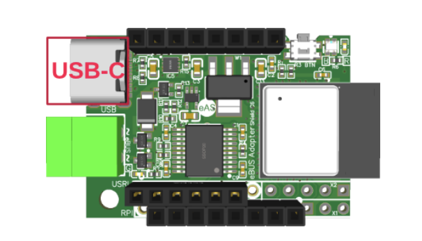

Which model should I get? Because this one (Daniel Kucera) keeps blocking my boiler every now and then
The eBus adapter shield C6 (Welcome to eBUS Adapter Shield - eBUS Adapter Shield C6) worked for me out of the box, without any change in settings or trimming needed.

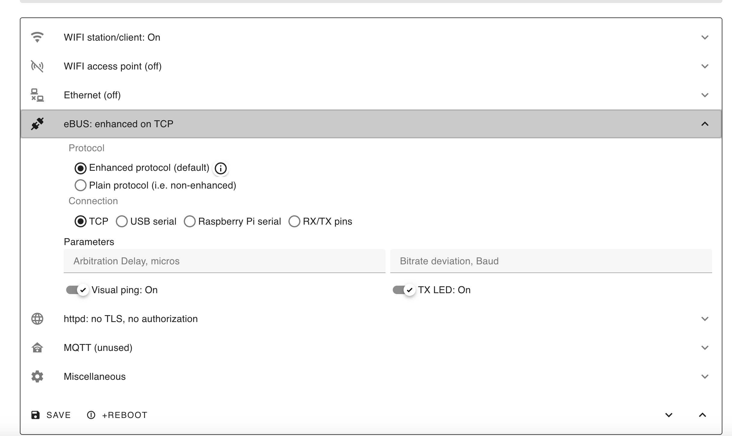

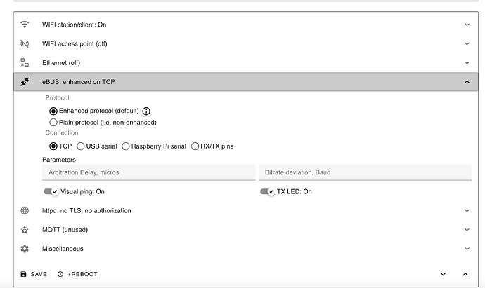

finally i got the new adapter. i connected it to my home wifi and updated the firmware.
how do i configure the ebus part?
Do I need to do any other configurations besides that?
No, it is enough.

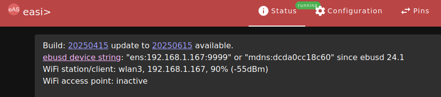

Now you have to set the ebusd addon to use the “enhanced” protocol.
Probably in the addon configuration you set the IP address of the previous adapter.
You need to change the connection string as ens:NEW_ADAPTER_IP_ADDRESS:9999.
Some hint are on the home page of the adapter web interface.
Wowww. I changed the port and ip and it worked perfectly right away. This seems much better than the adapter I had before. I think danman

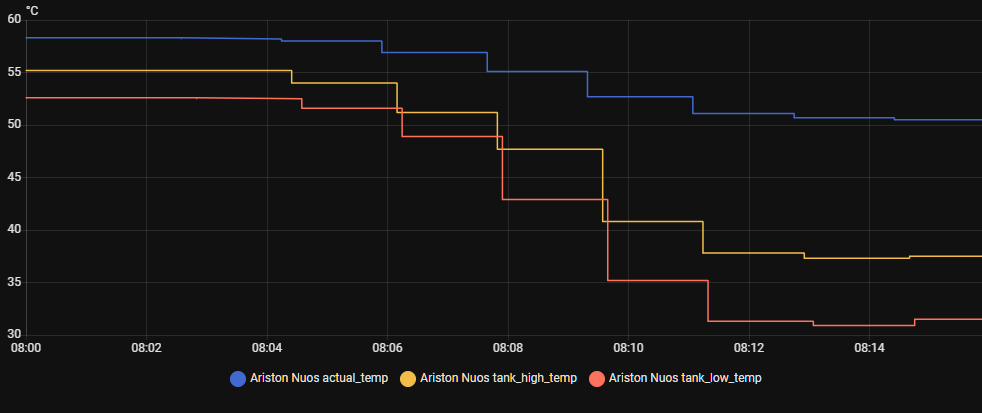

I own an Ariston Nuos Wifi 200L. The Ariston web api is awfully slow when trying to avoid IP-bans. With this EBUS interface, is it possible to:
  • read actual temp at 10s interval
  • set target temperature
  • set mode?
Set target temperature: Yes
Set Mode: Yes
Read actual temperature: Yes. But every 10 seconds would probably be to much for the bus of the Ariston. It would also be a bit of an overkil. The actual temperature is measured by the sensor in the dome of the tank and does not change that fast. Once every minute would be quite adequate for a storage water heater. Even taking a shower it does not change more than half a degree Centigrade every minute. See attached graph. In order to know how much hot water you still have available it is more useful to take into account all three temperatures: The temperature in the dome (shown as actual temp on the display), the temperature at about middle of the tank and the temperature right next to the cold water intake. It takes time for the overall temperature of the water in the tank to even out. See attached graph.
