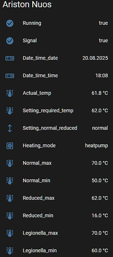

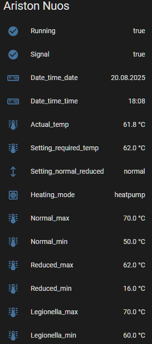

This shows the controls that I have for the Ariston Nuos WiFi:
And this shows the sensors:
