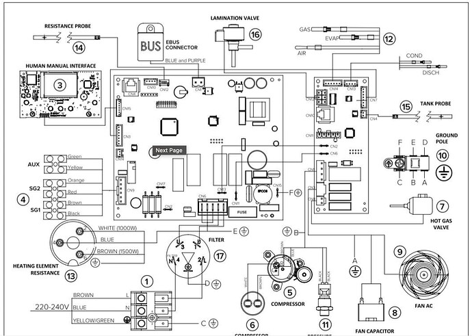

Now that I think about it a little more, this would be the schematics for my boiler:
So if I would check the eBus connector it would not be connected to anything right? So I could just buy a eBus adapter and connect it and control it through there? But how would I then find out the available commands to send?
The internal ESP module is probably used to “call home” to the Ariston Cloud.
The simplest way to integrate that boiler is via the eBus port.

Got you. What happens is probably the boiler connects to my router and then it exchanges http requests between himself and the ariston cloud servers. For some reason it’s not working, so my best bet would be to attach it an ebus adapter so I can make my own local connection. Correct?
Yes, buy an adapter (it costs 30/40€ shipped) then connect it to your bolier (bus port) and to your wifi. Then set up ebusd to decode the bus messages.
