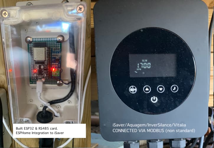

The iSaver with ESP Board and RS485 connecter
My first step…
