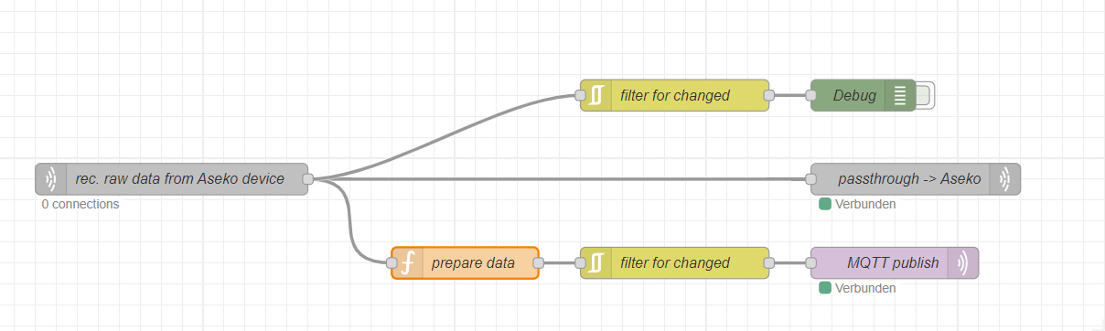

Id did that with a simple TCP Out node directly behind the TCP In node. Works fine until now.

Might be easier to setup a Flow in Node-RED especially if you have another device (eg SALT). But it seems to be good work and I used it to pimp my flow a little bit. But the main values for producing CL are still missing because I use an Aqua SALT device.

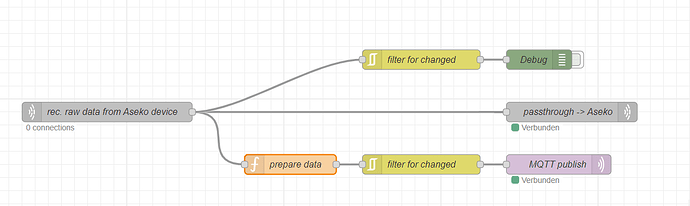

The flow is easy. It looks like this:
The JS Code for “prepare data” looks like this, but it’s not nearly ready and it will contain errors (I really don’t know, if I got the production right- it’s guessing only. There is no production at the moment):
