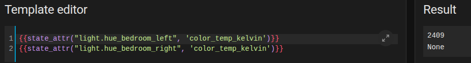

HUE lightbulbs, such as the 8719514392830 support color temperature, however this script seems to rely on a specific attribute which isn’t always supported:
Stopped Ashley’s Light Fader because a color fade was requested for HUE Left, but its current color temperature doesn’t seem to be defined using Kelvin units. (You can look into this by going into Developer Tools and checking that HUE Left has a defined “color_temp_kelvin” attribute.)
The attributes of this specific bulb:

Attached a test of two of these light bulbs, one turned on, the other off.
Could this receive an update targeting these specific cases?
My current workaround is to turn on the light first and then apply this script, because only then it will accept the kelvin setting.
@FPSUsername For multiple devices you should use the Home Assistant Group integration which allows you to group multiple entities together into a “single entity” … this will allow you to control multiple lights not only from this script but from any automation.
@handcoding However, I am also having the same kelvin issue and I also had to turn on the lights, do a delay and then run your script since the bulbs report no temperature while off.
