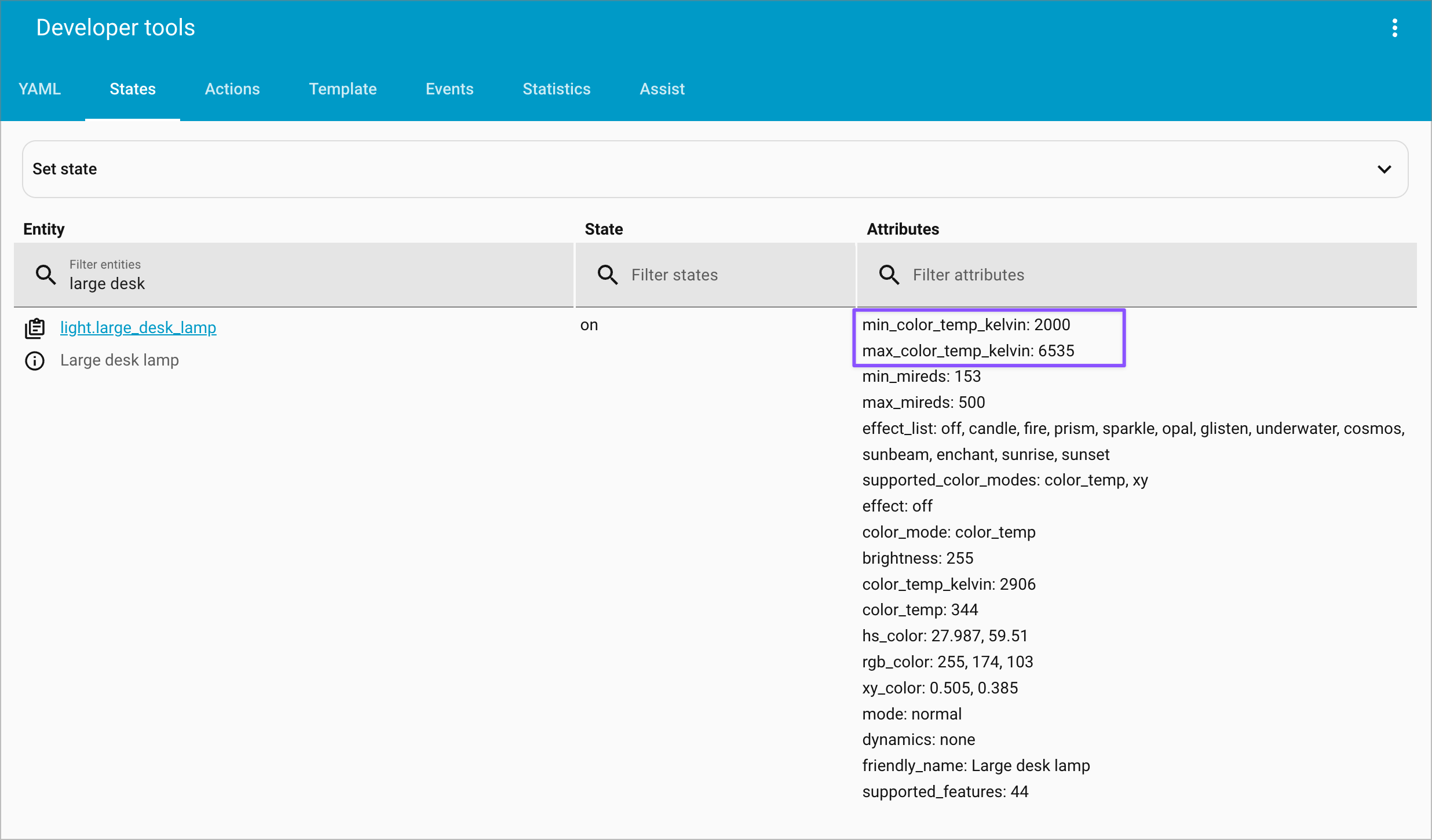

Hi, @alexk_privat!
It could be the case that your lights might not support setting their color using Kelvin units?
If it may help, here’s one way that you can check that:
  1. First, go to Home Assistant → Developer Tools [in the sidebar] → States [tab].
  2. Then, within the Filter entities field, start typing the name of your light.
  3. From there, under the Attributes column, you should hopefully see entries for min_color_temp_kelvin and max_color_temp_kelvin if your lights support Kelvin color temperatures.
For instance, here’s what I see when I search for one of my Hue lights using that screen:
