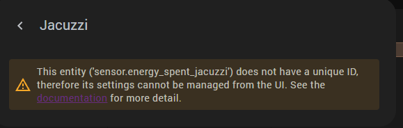

and that brings us to te main problem. Those custom energy_spent_xxx entities cannot be assigned to an area as they have no uniquie ID. Without that sankey in Energy dashboard is unsorted and looks really bad. Is there any workaround for that?

You can configure them with a unique_id.
unique_id string (Optional)
An ID that uniquely identifies the integration sensor. Set this to a unique value to allow customization through the UI.
