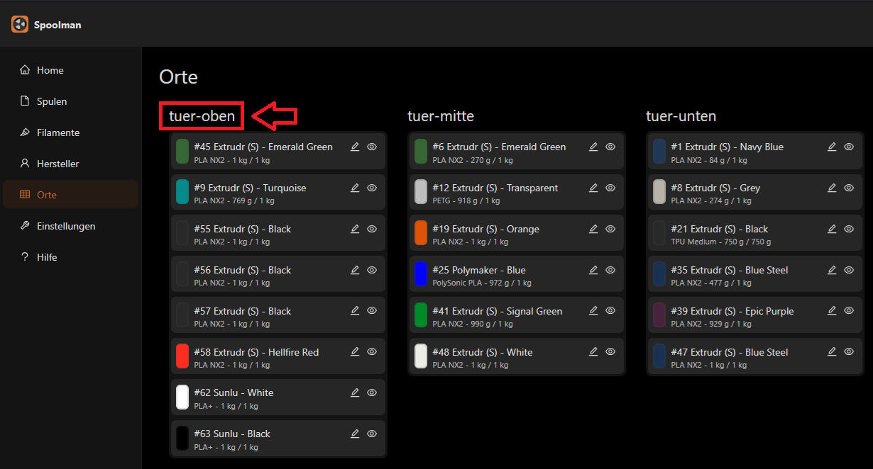

3) Naming Storage Locations in Spoolman
  • Connect words with hyphens.
  • No special characters, no umlauts (e.g., instead of “Tür” use “tuer”).
  • Use consistent spelling (e.g., all lowercase, 3d-printer-side instead of 3D printer side).

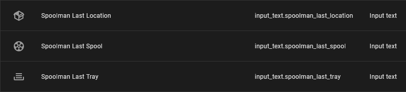

4) Helpers in Home Assistant
The automation uses input_text helpers to temporarily store the last scanned spool/location/tray. You need:
  • input_text.spoolman_last_spool - stores the last scanned spool tag
  • input_text.spoolman_last_location - stores the last scanned location tag
  • input_text.spoolman_last_tray - stores the last scanned tray tag
These helpers are simple text fields. After a successful assignment, the automation clears them again.

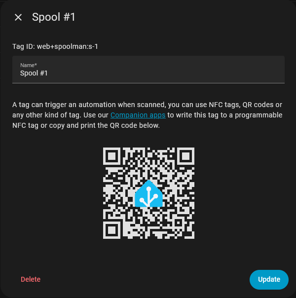

5) Tags - Format & Examples
So Home Assistant can decide whether a tag represents a spool, a location, or a tray based on the tag content, tags must be created using fixed naming conventions:
  • Location tag starts with web+spoolman:loc-
    Example: web+spoolman:loc-3d-printer-side
  • Spool tag starts with web+spoolman:s-
    Example: web+spoolman:s-37
  • Tray tag starts with web+spoolman:tray:
    Example: web+spoolman:tray:p1s_01p00x3b2000xxx_ams_1_slot_4
How to create tags in Home Assistant
In Home Assistant, you can create new tags under Settings → Tags and assign exactly these strings as the Tag ID. As the physical medium you can:
  • generate/print QR codes
  • write NFC tags
