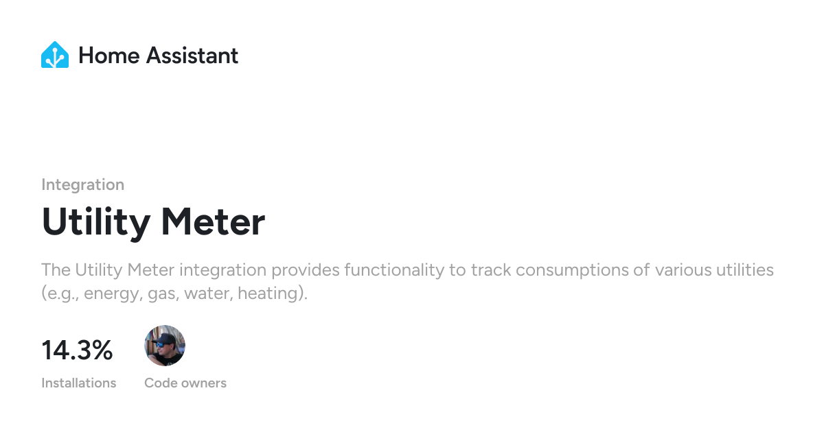

You might be able to make use of a utility meter and the tariff setting that it provides. The source would be the energy sensor of the plug and the tariff would be set to the name of the actual device that is plugged into the socket.
When you do this, the utility meter splits the usage over several utility meters, one for each tariff (so one for each device you might plug in). Those would be your sensor to use in the energy dashboard. They each only count usage when the tariff is set to the name of that specific device.
You would need to always use the same plug for each device. Otherwise you'd get multiple energy sensors for one device (one per plug it is used in).
Another useful trick: if you do not set a cycle on the utility meter then you will get an ever increasing total that never resets. So you do not need to make the utility meter a monthly or daily one.
