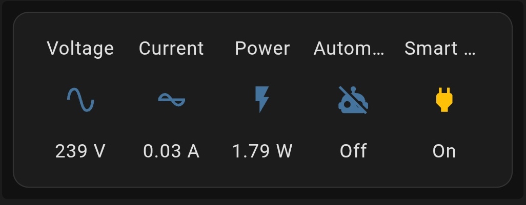

I’m trying to get the functionality of automation entity without having a dedicated button for it, in this example using the Glance card.
I wanted to remove the entity / button for automation to preserve some horizontal space and integrate the functionality into, for example, hold_action for one of the other entities. Is this possible?
By default all these entities have the hold_action and tap_action set to “more-info”, so I want to make the card more compact by differentiating the action taken with these interactions.
How do I assign the tap action of one entity to another?
For example, to achieve sensor.smart_plug_mini_voltage info when tapped and automation.turn_on_at_8am toggle when held down.

I want to switch it up to something like this to make it more compact and not loose any functionality.

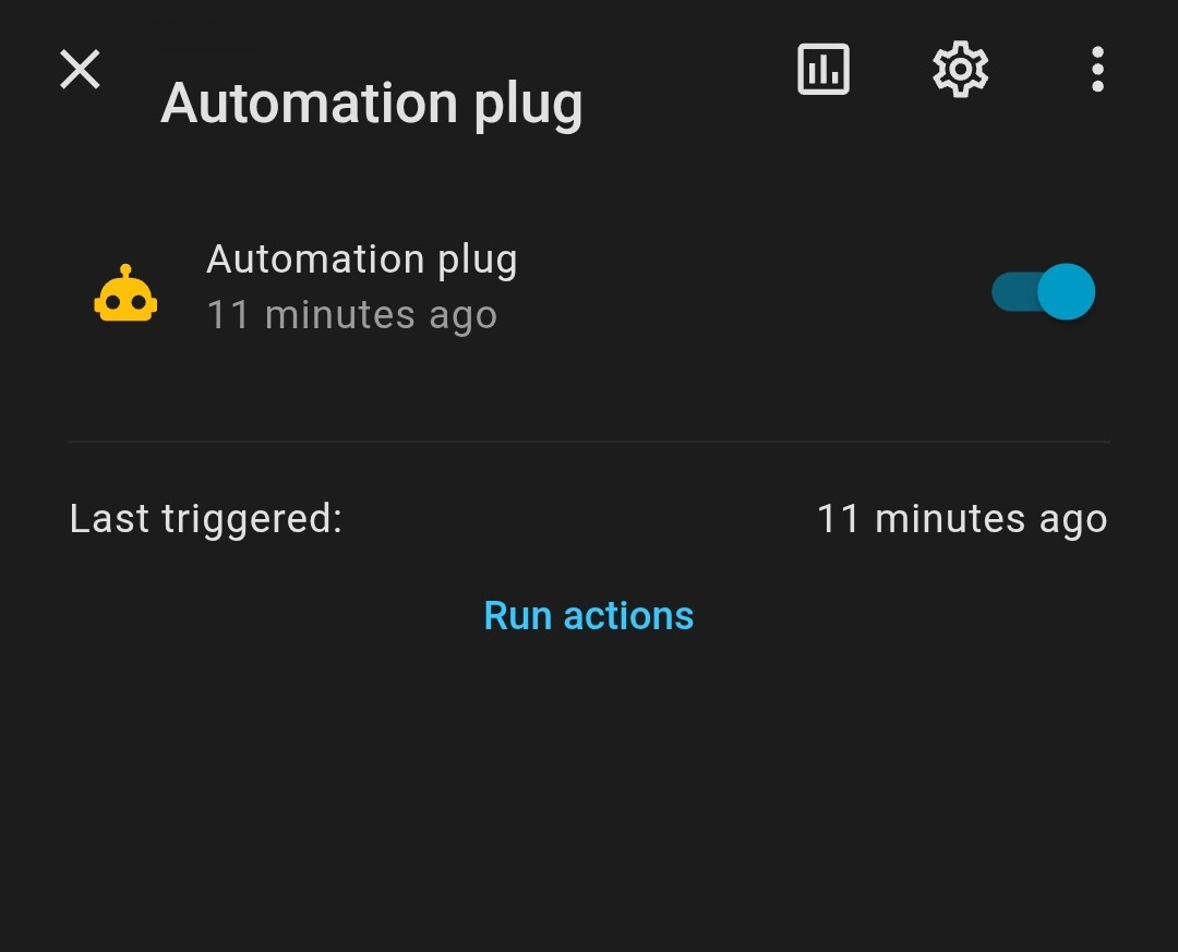

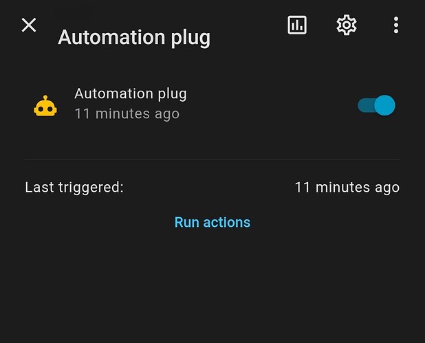

Thanks for your response!
This works, sort of.
Toggling is useful, but unfortunately automation.toggle can’t show me a current state of the automation, like I would be able see in the “more-info” styled tab.
And automations are, as far as I can tell: turn_on, turn_off, toggle, trigger, reload. So nothing that can show me its state, even in another menu.
So maybe a different approach to visualize the state of an automation.
Can I change the color of another entity based on the enabled / disabled state of the automation?
