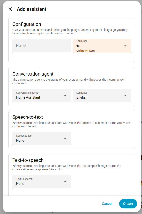

I've been having a weird issue and I would love your input on resolving it. I hope it's simply me being a dummy, but I've done some basic testing and I'm perplexed on what's causing it other than a bug.
Problem : after upgrading to 2026.6.3 from 2026.5.4, the english language is no longer available in Assist as the configuration language. This affects new and existing profiles, all other languages are working (my French profile works), but English is no longer available and usable by my assistant.

Do you have ideas of what could cause this and what debug steps I could do to identify where the issue is coming form?
