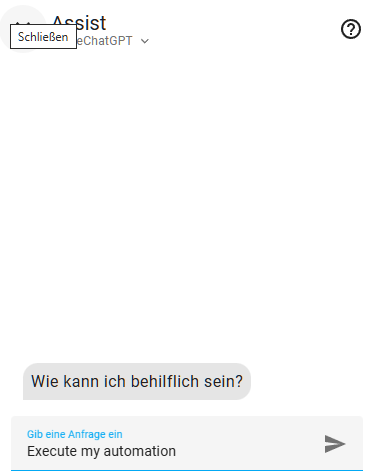

Just try it out:
Pass a sentence via Developer Tools → Actions:
action: conversation.process
  text: Execute my automation
  language: de
  agent_id: conversation.azure_openai_conversation
It will not execute automation.
Make the same with
It works.

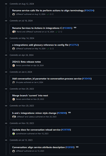

I can’t see in your issue listing why it shouldn’t work or that the Home Assistant instructions wouldn’t be up to date.
This is not a list of issues, but a log of updates to the documentation page. It can be said that it has not been updated since 2023.
You do not want to accept the information at all; I have already explained everything to you in my previous answers.
