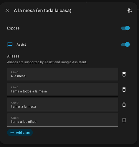

I’m having trouble adding an action (a script) to my exposed entities in Assist.
I have four entities exposed and they are all well, the pipeline works as expected. But when I try to add a script, Assist simply ignores it. I’ve tried adding buttons or input booleans with an automation to call the script, and they can be exposed… but not working as expected… I suppose it does not recognize buttons as actions.

So you can see there are 4 devices in there. But I do have 5 devices exposed:
I’ve tried adding other scripts with the same problem. If I add other types of devices, they show up in the system context.

I’ve got a script called ‘a la mesa’ that sends a voice message to all speakers at home, calling children to the table to eat, and I’m trying to get this action recognized with voice from my HA Voice PE.
And when I debug the pipeline (from the UI) I consistently get errors around home assistant not recognizing this sort of action, e.g. No puedo ayudarte con eso. No tengo información sobre llamadas o eventos relacionados con la mesa. Si tienes otra pregunta, por favor dime.
It would be great to see a bit more of what’s going on… is there anywhere I can see in the debug the functions that are being offered to the LLM?
Then, to answer your other point:

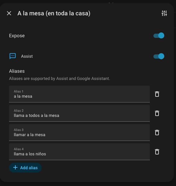

The script is already exposed (see my first screenshot)
I’ve tried adding all sorts of aliases to the script like this:
With no success.
Is there a way I can help the LLM by giving this action a good description of what it’s supposed to do? I could not find a description field in the script.
