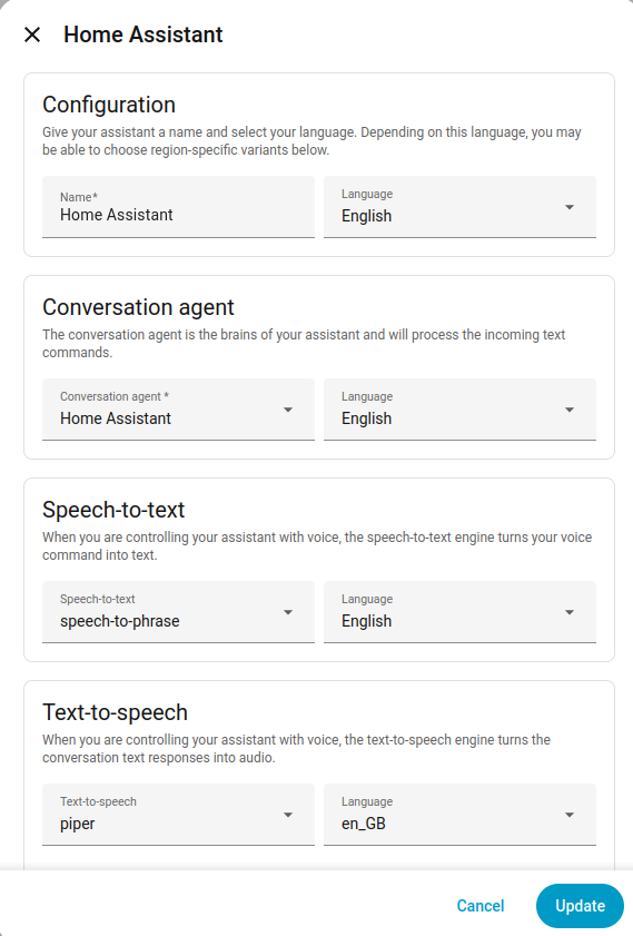

I’m trying to turn a surplus Android phone into a voice assistant using local voice only (no cloud or LLM, just the new Android wake word feeding speech-to-phrase with piper talking back (config screenshot below).
This works perfectly… once. It responds to the “Hey Jarvis” wake word and opens an Assist session. I then say “Turn the hall light on”: it does this and responds.
That’s when the problem starts: the Assist session is still open but the microphone input is off. I can’t do anything without tapping the on-screen microphone button for it to listen to the next command, or clicking the back button to end the session and wait for a new wake word.
Any ideas how I can make this work touch-free?
