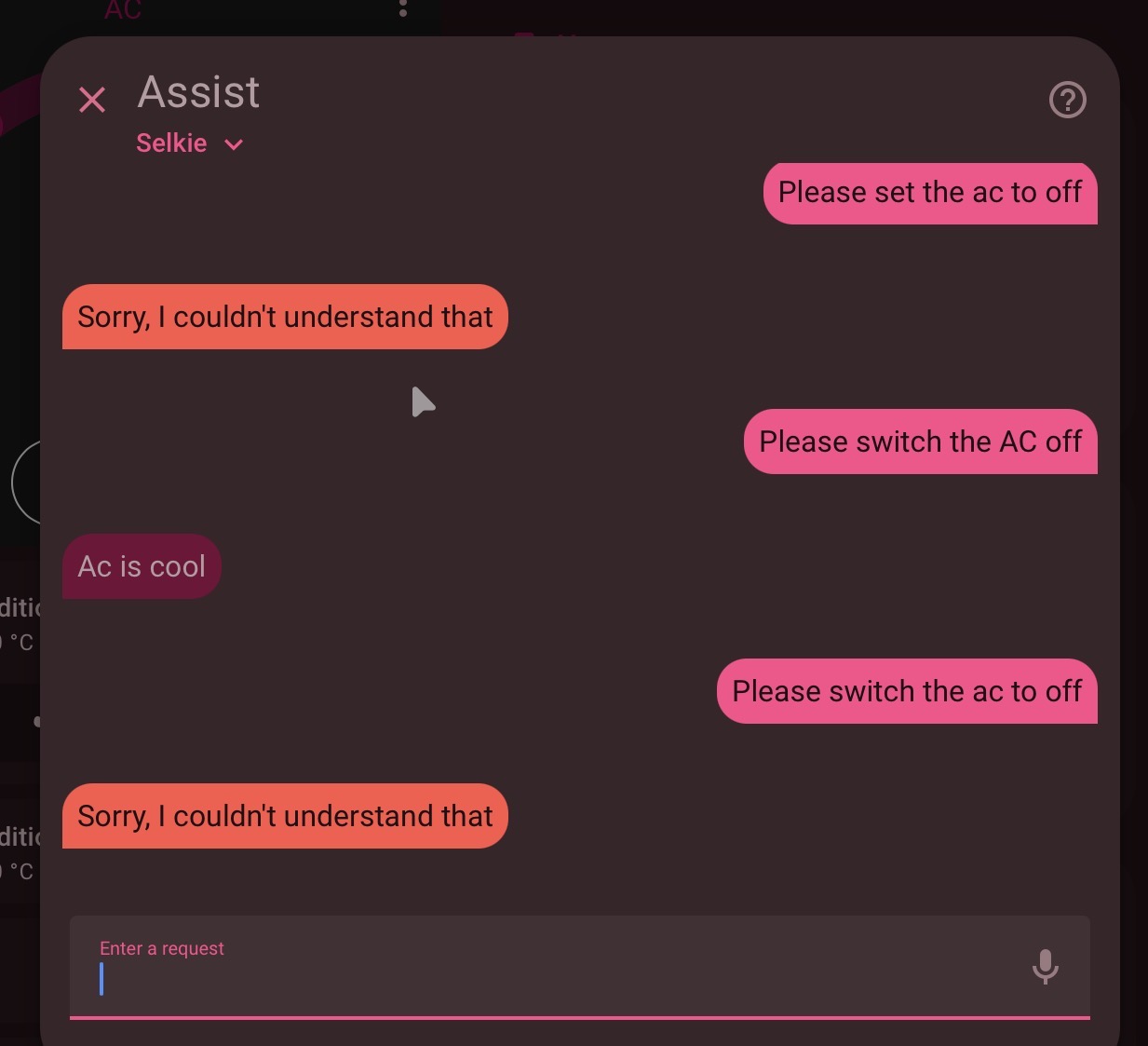

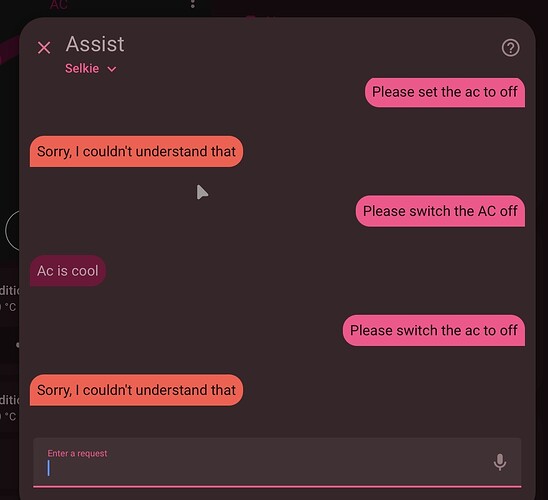

Here is a screenshot of the conversation:

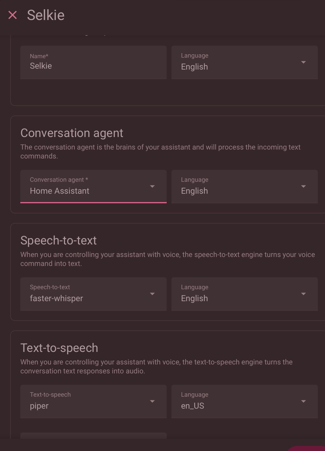

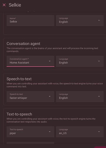

And the settings for the assist:

Yeah… based on the “Ac is cool” response it seems like it is exposed and is a climate entity. Looking at the HassTurnOff - name_only intents, climate entities aren’t included specifically, so OP will probably be best off using a custom sentence.
LOL, i disregarded/ignored that as i saw it as a “Wrong” answer to his Question :laughing:
And yes, it’s somehow only possible to get &set temp, when i try to turn on/off it says “Dont know that Device” :upside_down_face:
