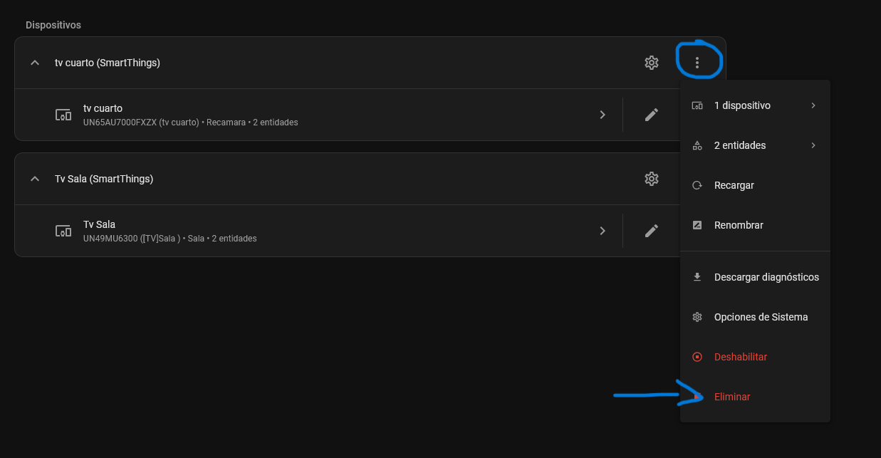

  • Open Home Assistant in your web browser.
  • In the left sidebar, click on “Settings”.
  • Go to “Devices & Services”.
  • In the Integrations section, find the Philips Hue integration box. It might be labeled something like:
    • “Hue (bridge)” or
    • “Philips Hue: [IP address]”
  • Click on the three dots (•••) in the top right corner of that box.
  • Select “Delete” or “Remove”.
  • You may be asked to confirm. Confirm the deletion.That’s it — the Hue integration will be removed.
That is as simple as that… By deleting the Philips Hue integration, all devices and scenes will also be deleted (removed) from HA…
