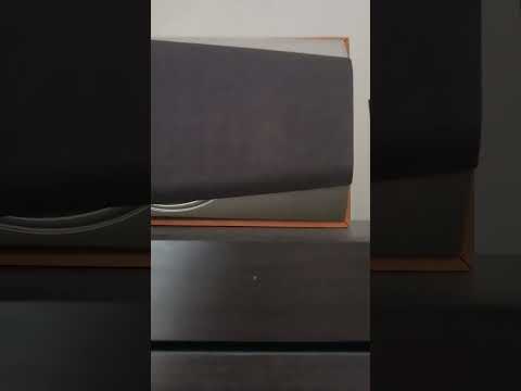

I made my own.
It detects voicemail messages and creates a mp3 playlist with all the recordings. I tried to make it one mp3 but that failed. But Google assistant can only play the 1st recording in the playlist. So I use my speaker system.
it uses gtts to make announcements of the voicemail and i have made a script to detect callers names using khard.
run it as a crontab on the asterisk server. and make a mediaplayer play the m3u file as playlist.
