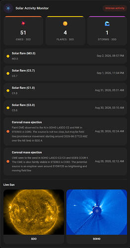

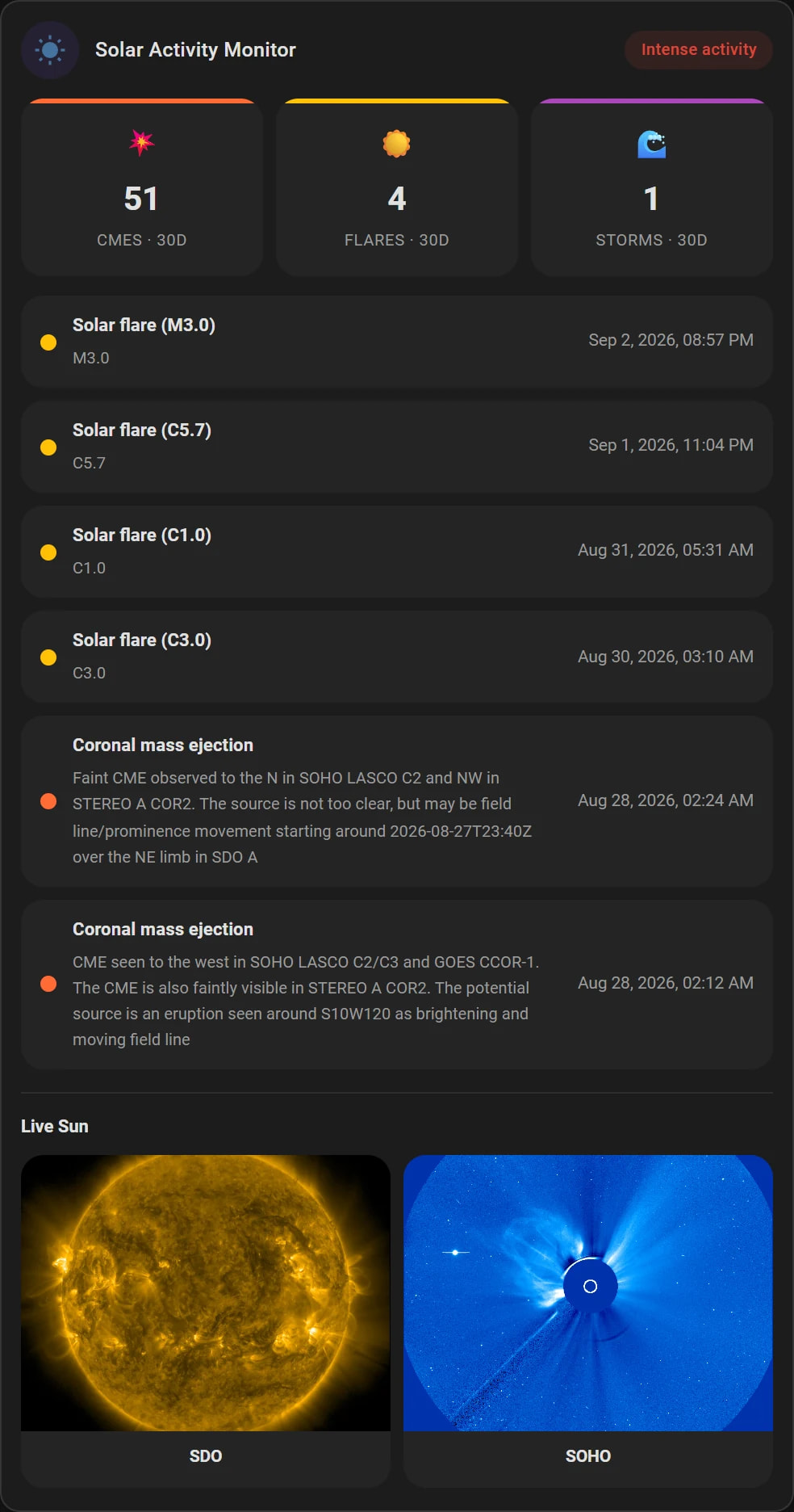

Solar Activity — CMEs, solar flares, geomagnetic storms, KP index and live solar imagery in one dashboard view.

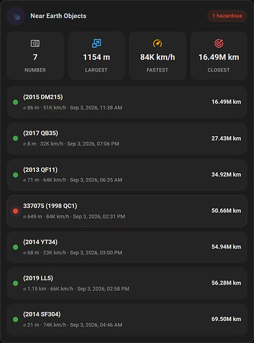

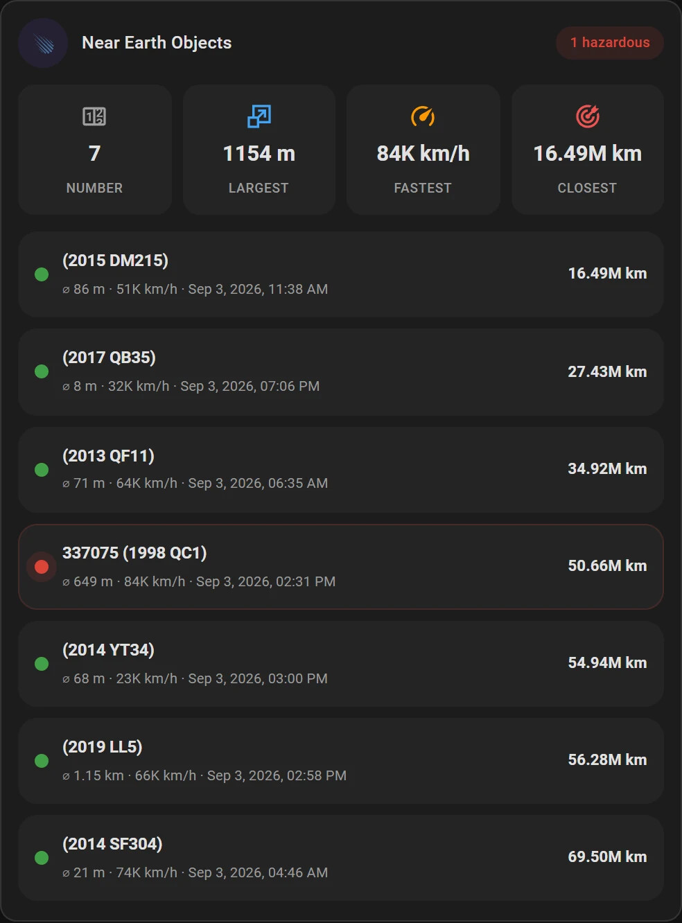

Near Earth Objects — seven asteroids on approach. 337075 (1998 QC1) is flagged hazardous: 649 metres across, travelling at 84,000 km/h, passing at 50.66 million km.

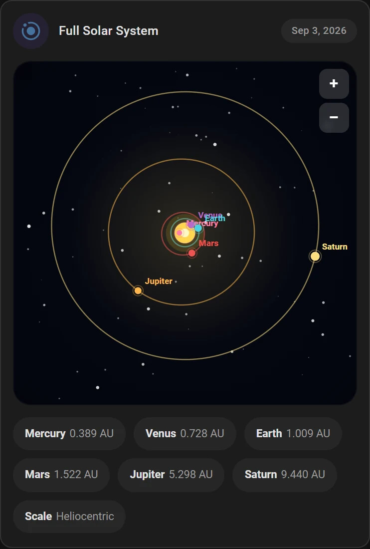

Solar System — a real-time heliocentric orrery. Every planet’s position comes from orbital mechanics calculated locally, with live distances in astronomical units.

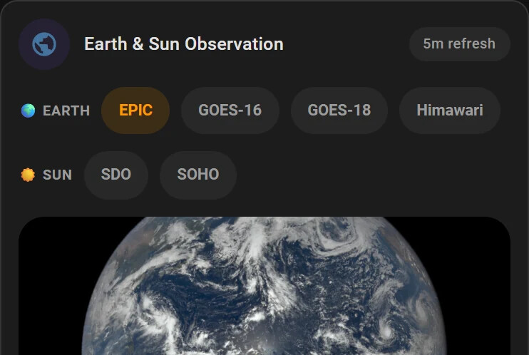

Earth & Sun Observation — full-disk natural colour Earth from NASA’s EPIC camera aboard DSCOVR, with GOES-16, GOES-18, Himawari-8, SDO and SOHO all one tap away.

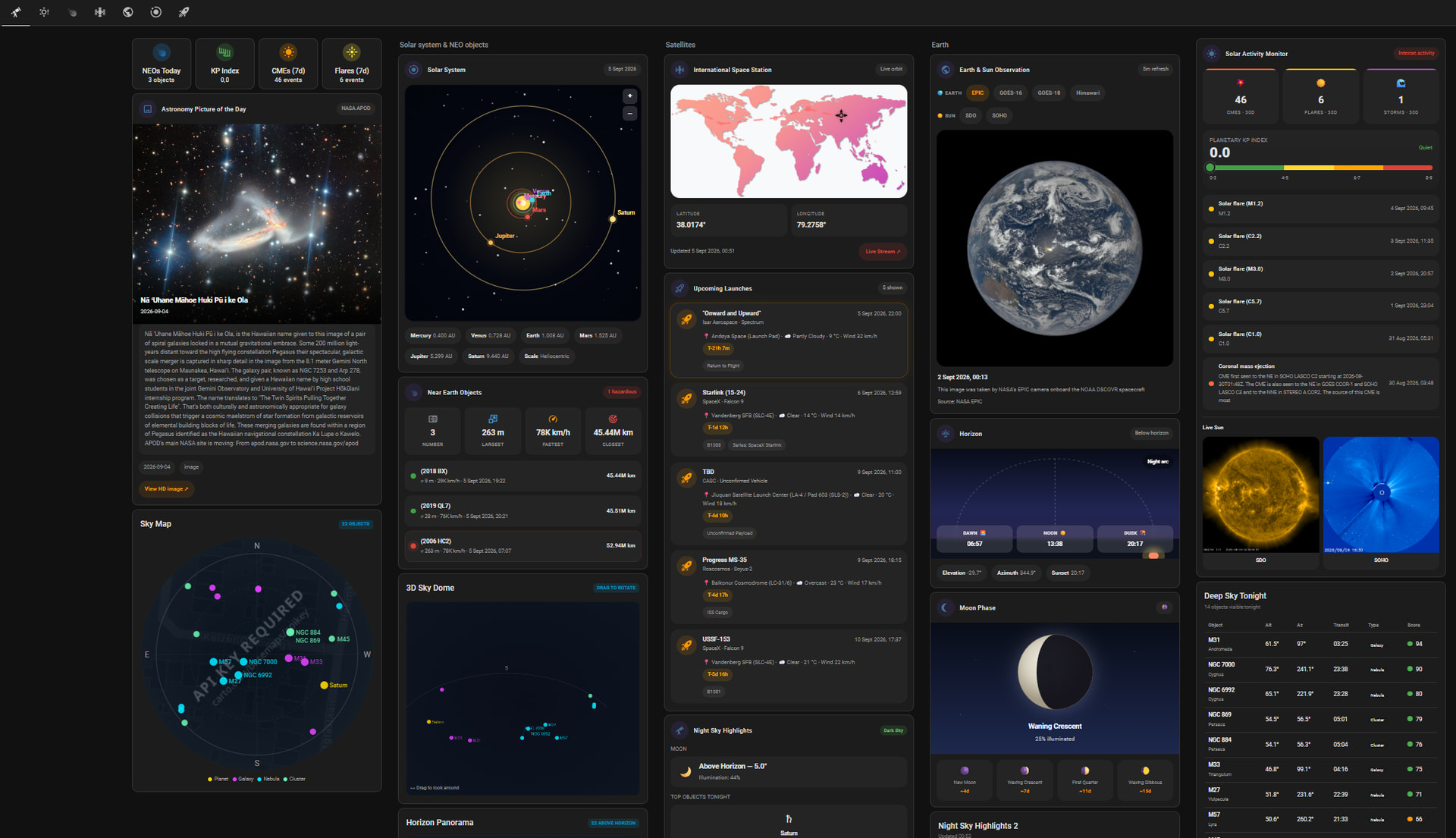

Heres a full view, If your interested in space , anything from where the ISS is, what you can see over your home in the night sky right now. which rockets launching when and where. position of the planets in the solar system . sun , moon elevation etc. and what ever automation you can think of coming from these sensors.
and yes I used some AI assisted coding, but who cares :slight_smile:

Earth Observation Can you add or provide option to change to cameras that cover UK and Europe ?
if you can give me the earth observation urls ofcourse :slight_smile:

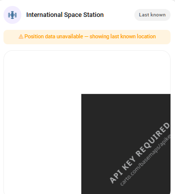

playing around with the cards, noticed a map issue that HA itself also had until september release:
the api key required message and no map. Not major, but maybe fixable for you

@hotsauce yes i’ll fix this in next release
