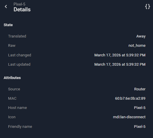

The Randomized MAC address does not appear to be the problem. After disabling this (setting the phone to use Device MAC), the ASUSWRT integration still reports the device as Away when connected via LAN.
When the Pixel 5 is connected to Wifi:
When connected via LAN:
No IP address when connected via LAN, could this be the cause? Why would there not be an IP?
What can I try next?

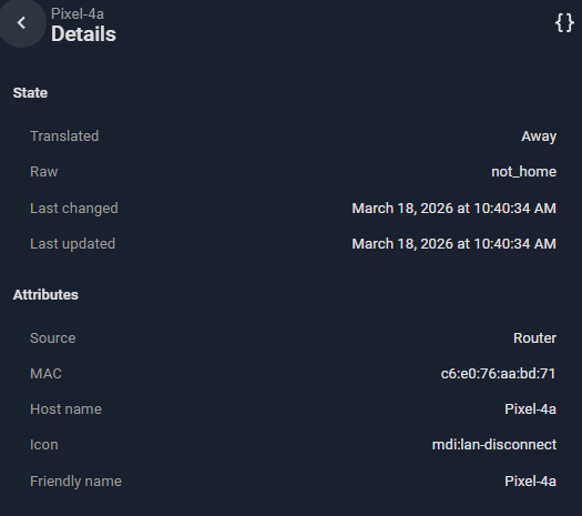

For example, when I connect my Pixel 4a to the dock:
What the ASUSWRT integration shows for this same Pixel 4a when it is connected to the dock:
The ASUSWRT integration incorrectly reports that devices connected to the dock are not connected.
This might be a bug in the integration or the AsusWRT firmware.
