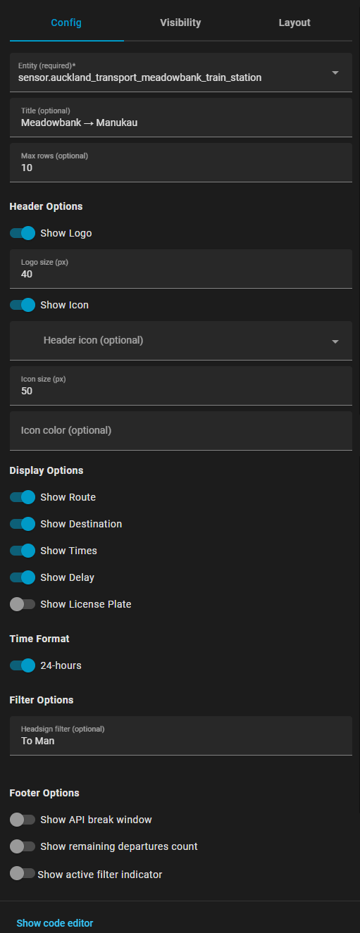

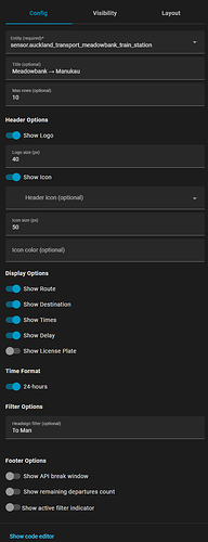

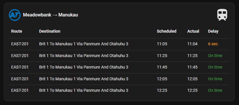

The custom Auckland Transport Card is available on GitHub now.

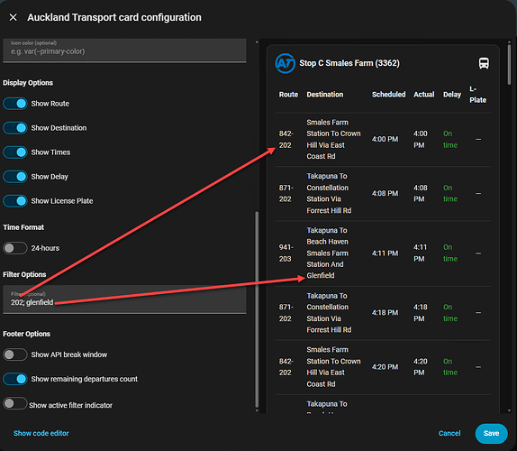

I am working on v0.2.0 at the moment which supports this. The filter includes both route and headsign. With semicolons you can include additional trips.
Let me know if you could help testing.
@digitalmacdonald
Version v0.2.0 released supporting both route and headsign as well as include addtional trips via semicolon.
