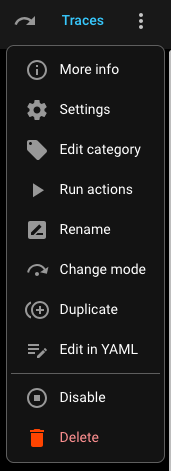

  6. create an automation go to Settings > Automation > + new Automation
    Screenshot 2026-02-11 at 11.37.24
  7. click on the top right 3 dots and change the edit mode by clicking Edit in YAML
  8. paste the bellow code in the automation code window:
