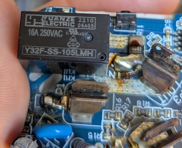

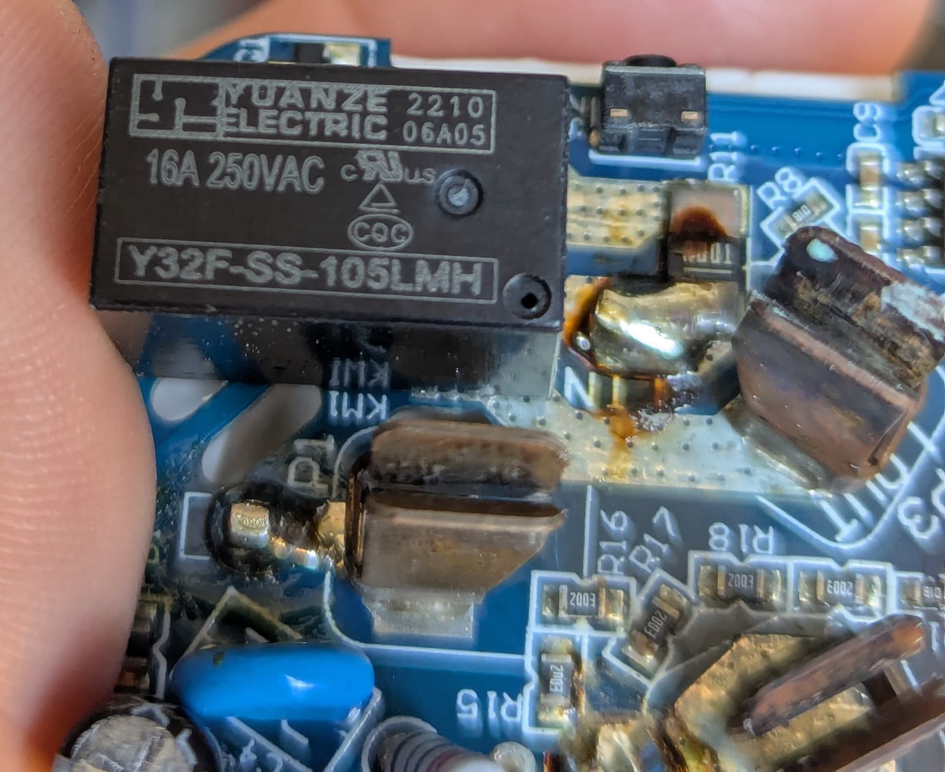

so my relays keep sticking and I have to bash the pack to get them to unstick just wondering if anyone know a good swapin replacement upgrade ?
what are people considering a failure ?
to me a failure is fried circuit board / no connection
switch not working to me is not a failure just wear n tear
I used my reflow heat gun ~ 250 deg to soften it and pried in , looks like the bottom is the way to go I have a feeling they might be pushing something down into the prongs to push the units apart as I did not really notice any glue or clips just press fitted
