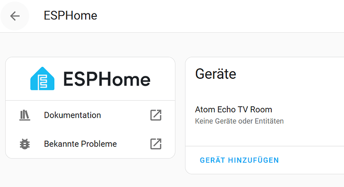

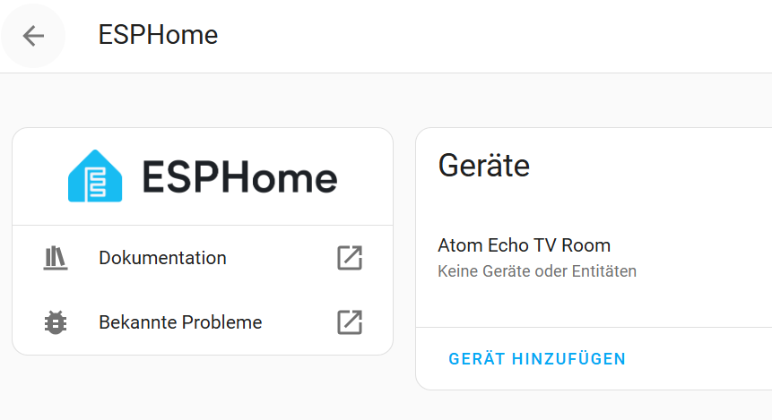

I have flashed the M5 Stack Atom Echo PICO with the prebuilt voice assistant binaries, went through the chrome based wizard and added the integration to HA.
Unfortunately the device does not show any entities in HA:
I tried everything like removing and adding the device again. Building my own configurations with ESPHome Device Builder and also with esphome python programm.
The Atom echo shows being responsive on the console log, but the integration on HA is not offering the expected entities and settings.

[10:27:16.780][C][wifi:1037]:   IP Address: 192.168.188.72
[10:27:16.780][C][wifi:1048]:   SSID: 'Strahlenkanone'
[10:27:16.780][C][wifi:1048]:   BSSID: 1C:ED:6F:36:A9:AD
[10:27:16.780][C][wifi:1048]:   Hostname: 'atom-echo-tv-room'
[10:27:16.794][C][wifi:1048]:   Signal strength: -75 dB ▂▄▆█
[10:27:16.794][C][wifi:1048]:   Channel: 11
[10:27:16.794][C][wifi:1048]:   Subnet: 255.255.255.0
[10:27:16.794][C][wifi:1048]:   Gateway: 192.168.188.1
[10:27:16.794][C][wifi:1048]:   DNS1: 192.168.188.1
[10:27:16.794][C][wifi:1048]:   DNS2: 0.0.0.0
[10:27:16.814][W][component:430]: wifi cleared Warning flag
[10:28:12.654][I][safe_mode:066]: Boot seems successful; resetting boot loop counter
[10:28:15.246][D][esp32.preferences:155]: Writing 1 items: 0 cached, 1 written, 0 failed
[10:31:19.750][D][binary_sensor:047]: 'Button' >> ON
[10:31:19.911][D][binary_sensor:047]: 'Button' >> OFF
[10:31:19.978][W][micro_wake_word:356]: Wake word detection is already running
[10:31:21.738][D][binary_sensor:047]: 'Button' >> ON
[10:31:22.059][D][binary_sensor:047]: 'Button' >> OFF
[10:31:22.123][W][micro_wake_word:356]: Wake word detection is already running
[10:31:22.590][D][binary_sensor:047]: 'Button' >> ON
[10:31:22.846][D][binary_sensor:047]: 'Button' >> OFF
[10:31:22.907][W][micro_wake_word:356]: Wake word detection is already running
[10:32:15.997][D][micro_wake_word:325]: Detected 'Hey Jarvis' with sliding average probability is 0.97 and max probability is 0.98
[10:32:15.997][E][voice_assistant:546]: No API client connected
[10:32:15.997][D][voice_assistant:482]: State changed from IDLE to IDLE
[10:32:16.013][D][voice_assistant:489]: Desired state set to IDLE
[10:32:16.013][D][micro_wake_word:370]: Stopping wake word detection
[10:32:16.013][D][micro_wake_word:378]: State changed from DETECTING_WAKE_WORD to STOPPING
[10:32:16.029][D][micro_wake_word:274]: Inference task is stopping, deallocating buffers
[10:32:16.029][D][micro_wake_word:279]: Inference task is finished, freeing task resources
[10:32:16.045][D][micro_wake_word:378]: State changed from STOPPING to STOPPED
[10:32:16.781][D][wifi:2133]: Roam scan (-71 dBm, attempt 1/3)
[10:33:18.652][D][api:139]: Accept 192.168.188.52
[10:33:18.652][W][component:430]: api cleared Warning flag
[10:33:18.652][D][api.connection:2221]: aioesphomeapi (192.168.188.52): connected
[10:33:18.670][D][api.connection:2221]: aioesphomeapi (192.168.188.52): disconnected
[10:33:18.685][W][api.connection:2226]: aioesphomeapi (192.168.188.52): Reading failed CONNECTION_CLOSED errno=128
[10:33:18.685][W][component:390]: api set Warning flag: unspecified
[10:33:18.701][D][api:139]: Accept 192.168.188.52
[10:33:18.701][W][component:430]: api cleared Warning flag
[10:33:18.717][D][api.connection:2221]: Home Assistant 2025.2.5 (192.168.188.52): connected
[10:33:48.765][W][api.connection:2226]: Home Assistant 2025.2.5 (192.168.188.52): Reading failed CONNECTION_CLOSED errno=128
[10:33:48.766][D][api:139]: Accept 192.168.188.52
[10:33:48.766][D][api.connection:2221]: Home Assistant 2025.2.5 (192.168.188.52): connected
[10:33:57.965][D][api:139]: Accept 192.168.188.52
[10:33:57.965][D][api.connection:2221]: aioesphomeapi (192.168.188.52): connected
[10:33:57.981][D][api.connection:2221]: aioesphomeapi (192.168.188.52): disconnected
[10:33:57.998][W][api.connection:2226]: aioesphomeapi (192.168.188.52): Reading failed CONNECTION_CLOSED errno=128
[10:34:18.857][W][api.connection:2226]: Home Assistant 2025.2.5 (192.168.188.52): Reading failed CONNECTION_CLOSED errno=128
[10:34:18.873][W][component:390]: api set Warning flag: unspecified
[10:34:20.789][D][api:139]: Accept 192.168.188.52
[10:34:20.805][W][component:430]: api cleared Warning flag
[10:34:20.805][D][api.connection:2221]: Home Assistant 2025.2.5 (192.168.188.52): connected
Can you help?
Thanks in advance!
I managed it by updating the Home assistant core. Since that it works
