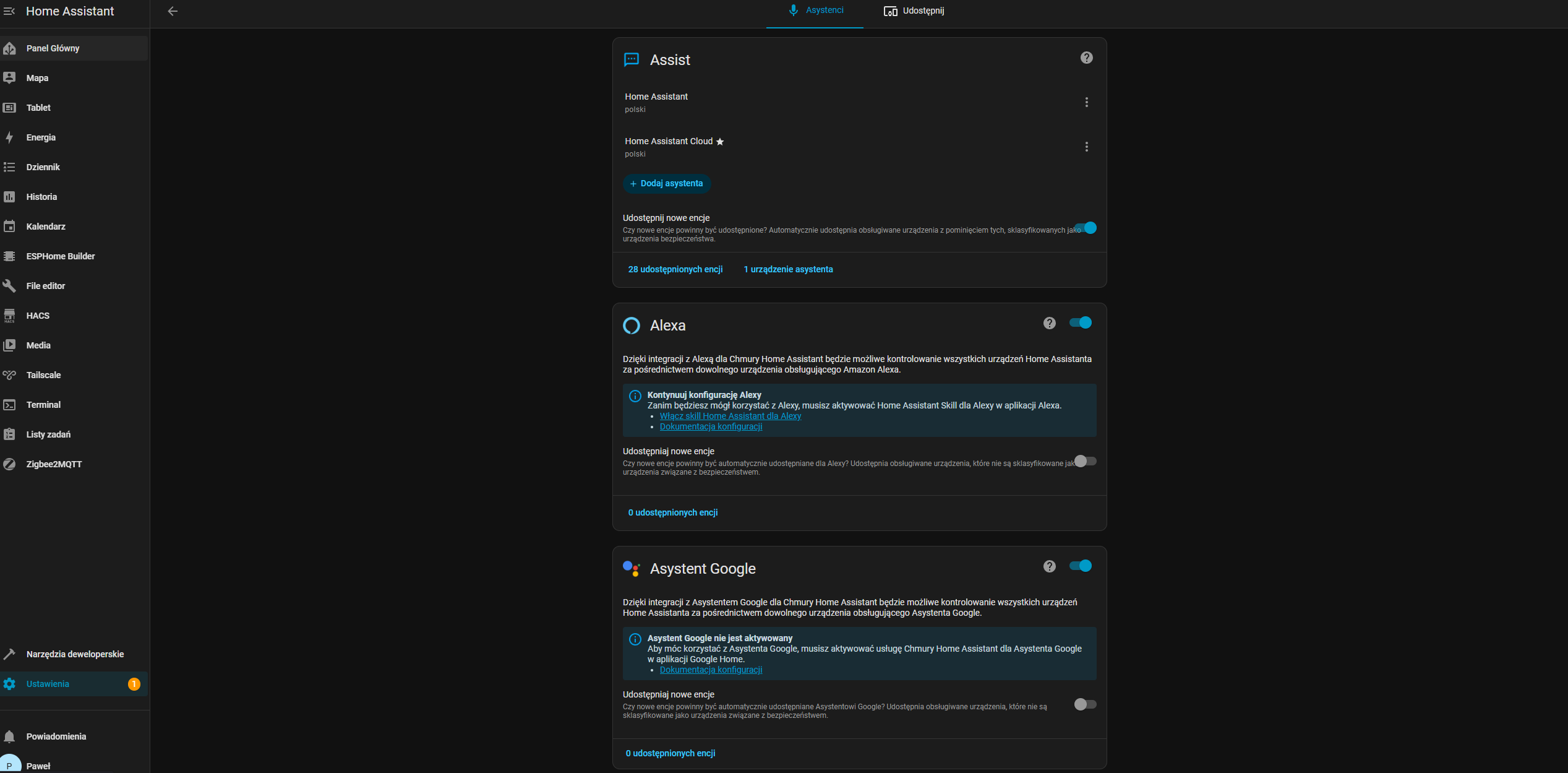

Can you post a screenshot of
Open your Home Assistant instance and show your voice assistants.
Yeah, sure. Thanks for trying to help :slight_smile:
So you are using HA Cloud! :+1:

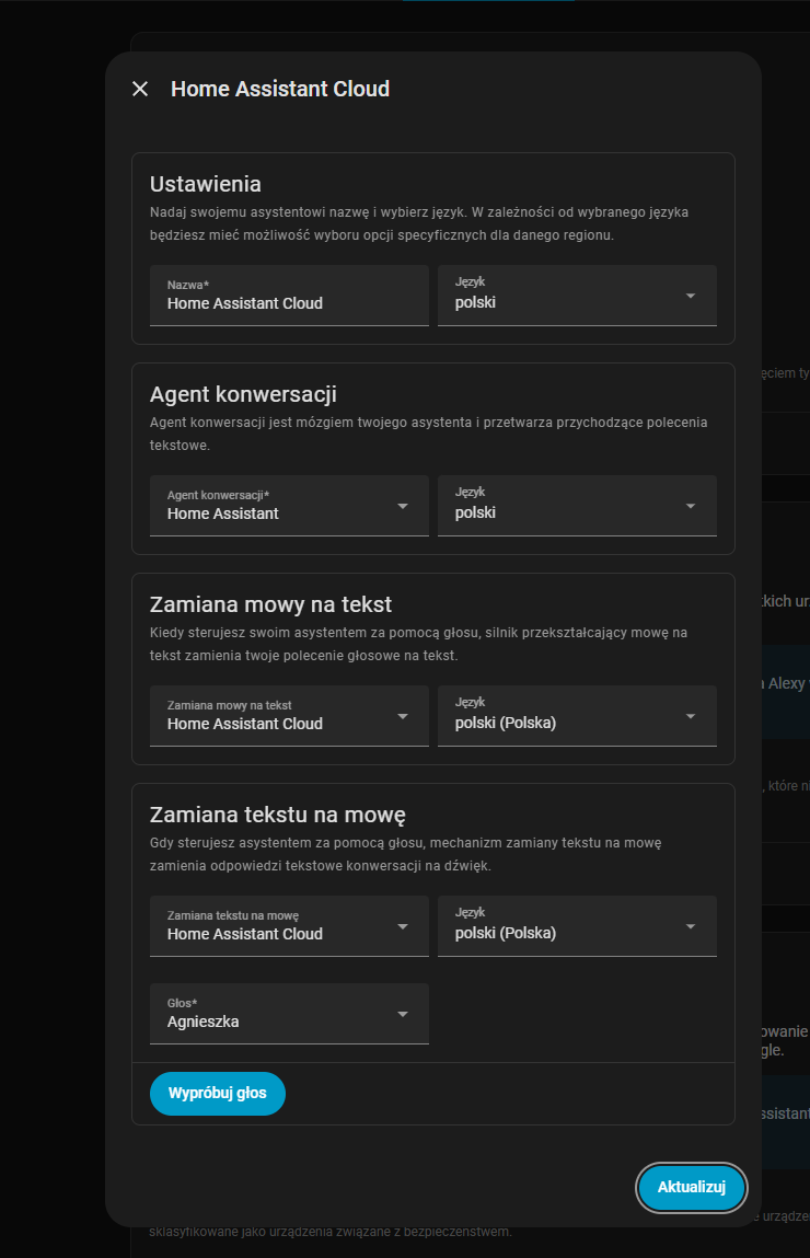

Can you open up the “Home Assistant Cloud” entry of the assistants.

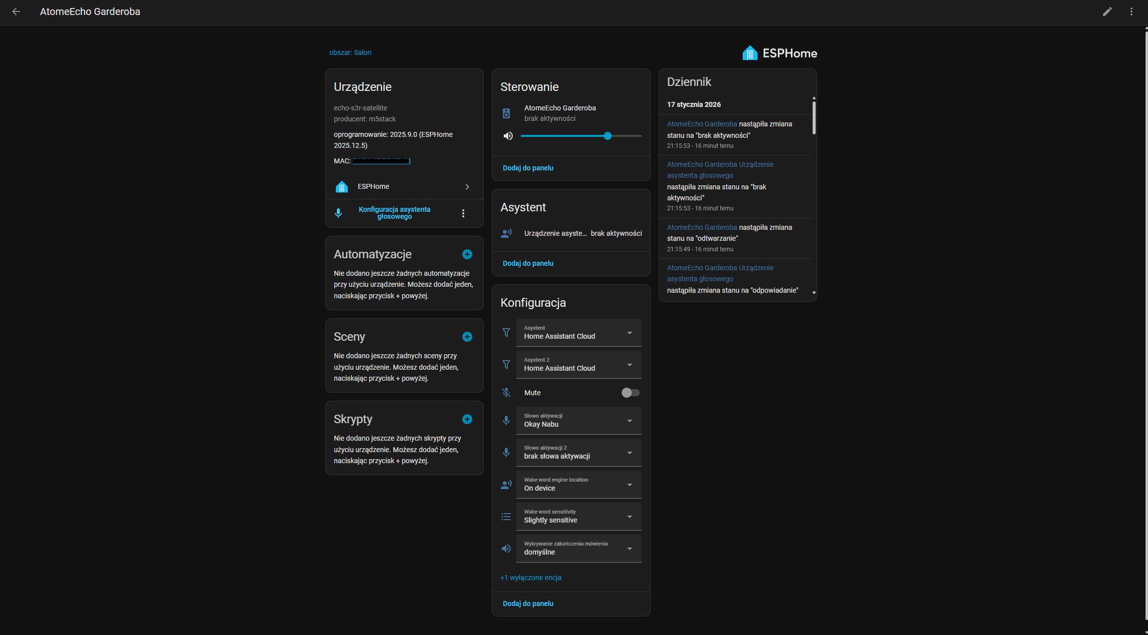

Also, show the configuration panel of the Atom Echo (in Settings → Devices & services → ESPHome → Your Echo)
Open your Home Assistant instance and show your integrations.
So far it seems OK.
Have a look at this to find the way to construct sentences: intents/sentences/pl at main · OHF-Voice/intents · GitHub
Also, in
Press on the 3 dots behind “Home Assistant Cloud” and select ‘Debug’ to see what is made from your commands.
