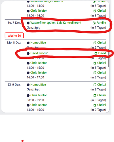

I’m using Atomic Calendar Revive on my dashboard and have customized it to my liking.
However, I can’t figure out how to change the color for different channel sources so that it’s immediately noticeable.
Does anyone have any ideas on how to do this?

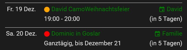

Thanks! Its is great! But it only change the DOT before the Text… Is it possible to change the Text color also?
So you have card mod installed?
Yes, i did. But with your answer it changes only the DOT …

I haven’t checked in on the forum for a while, sorry for the late reply.
The entries above under you car-mod settings are overriding the colors set in the entity YAML. If you remove those the color of the title should be the colors you have chosen in the YAML.
