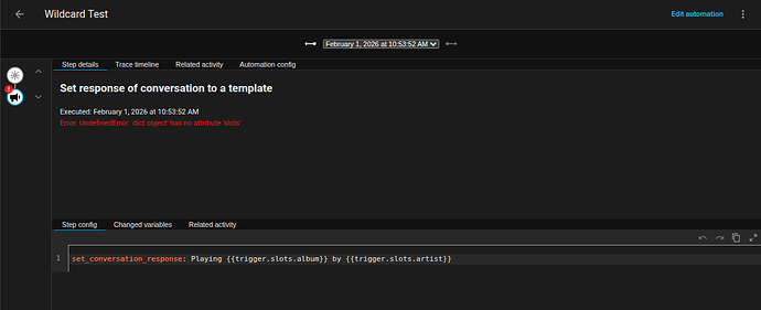

Appreciate the speedy response! So I’ve done that as well, but it generates the error I mentioned in the main post:
Error: UndefinedError: ‘dict object’ has no attribute ‘slots’

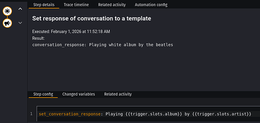

I just tested what I posted above and it works:
So I just tried using the debug under the Voice Assistant section and sent it a message. It did indeed repeat the message back, which is crazy. I literally did this several times last night and this is the first time it responded back. However, when I actually say the phrase to my voice assistant. Nothing happens at all.
The trace screenshot you posted shows that the trigger wasn’t used… like it was fired using the “Run Actions” menu button or the automation.trigger action. With either of those there is no value assigned to the trigger object, so that error is expected.

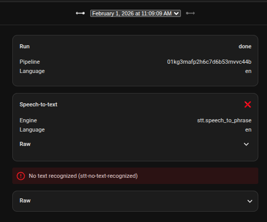

Thanks again for taking the time to work with me on this. This is what occurs when I speak directly into the voice preview:
That shows it is using Speech-to-phrase, which I’m not that familiar with, but based on the docs it looks like it will require you to set up a list of allowed values for album and artist.
I actually just went through this exact process for the first time a few days ago (using speech to phrase). I can confirm that I got erratic results every time I setup or changed the sentence/conversation triggers; typically it would respond that it didn’t understand when I tried to talk to my phone or watch. This was incredibly frustrating and confusing (and led to a lot of profanity being yelled at said device Ha). I ASSUME that it’s doing some updating in the backend to include the sentence/conversation triggers in its list of possible phrases (obviously being more complicated by the fact that there are wildcards as well). I tried restarting the speech to phrase add-on with mixed results, thinking this MIGHT trigger this updating process.
HOWEVER, after trying it again a few hours later, it’s since worked flawlessly since. So you probably just need to wait a short bit.
