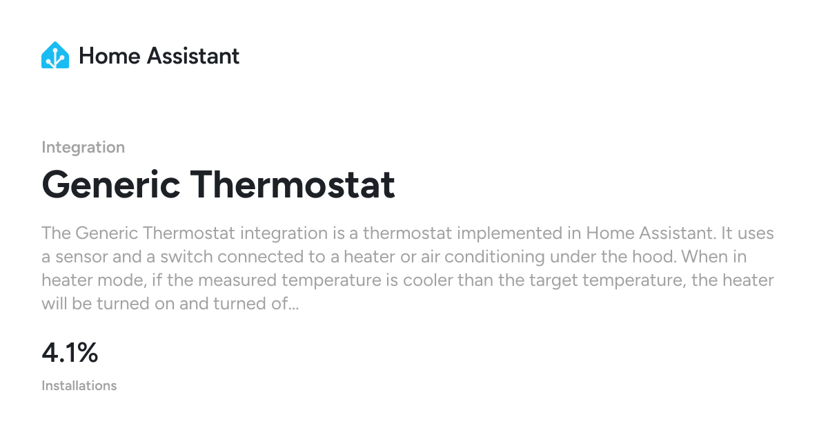

Sure that will work, consider using the generic thermostat.
With it you get UI and good control. For example, if the temperature sensor fails (stops reporting) it'll turn the fan off - which is better than just running forever.
