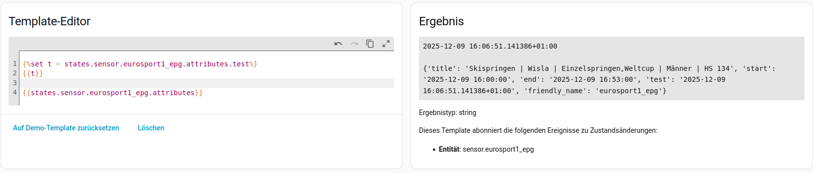

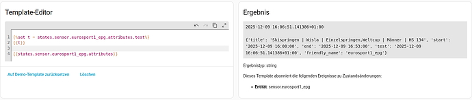

I’m having trouble defining an attribute as “datetime”. Whenever I access it, the object is displayed as a string.

          - name: test
            value_template: "{{as_datetime(now())}}"
Is there a way to pass a “datetime” object directly as an attribute in multiscrape?

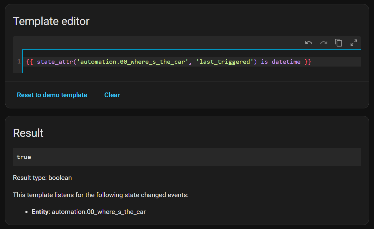

That’s not true, attributes can be native types like integers, floats, booleans, lists, mappings/dictionaries and also datetime objects.
For example, the last_triggered attribute of an automation is a datetime object, not a isoformat datetime string.
However, the template parser converts datetime objects to a datetime string, so using templates you won’t be able to set a datetime object as attribute.
