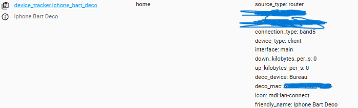

I have a TP-Link mesh network at home. It allows me to see who is in which room. Apparently, devices regularly disconnect, making the devices in that room unavailable.
See images.
Unavailable
If the device_tracker is unavailable, certain attributes disappear! This causes the attribute for my other sensor to become null.
See image.
Sensor Home
Sensor unav
Is it possible that if the device_tracker becomes unavailable, the attribute for my sensor won’t change?
See image.
Can anyone help me? Thanks for all the replies!
