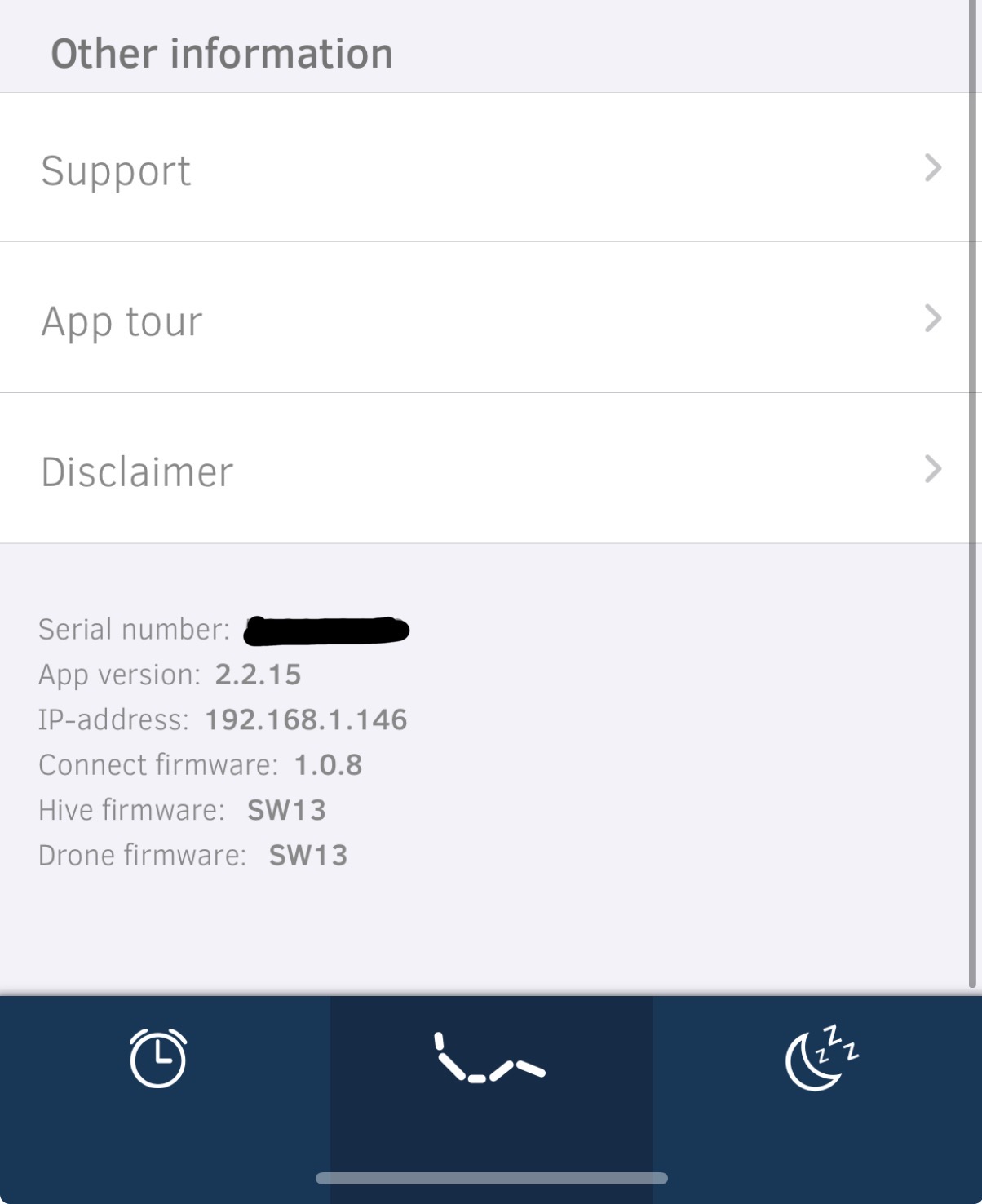

For those interested, I implemented this today for the older one (the wifi, not bt).
In case you wonder what your Key is, it’s the same one as the code that you can use under settings → share.

I don’t see a share option, where did you find this? I’m using an iOS app. Thanks!
