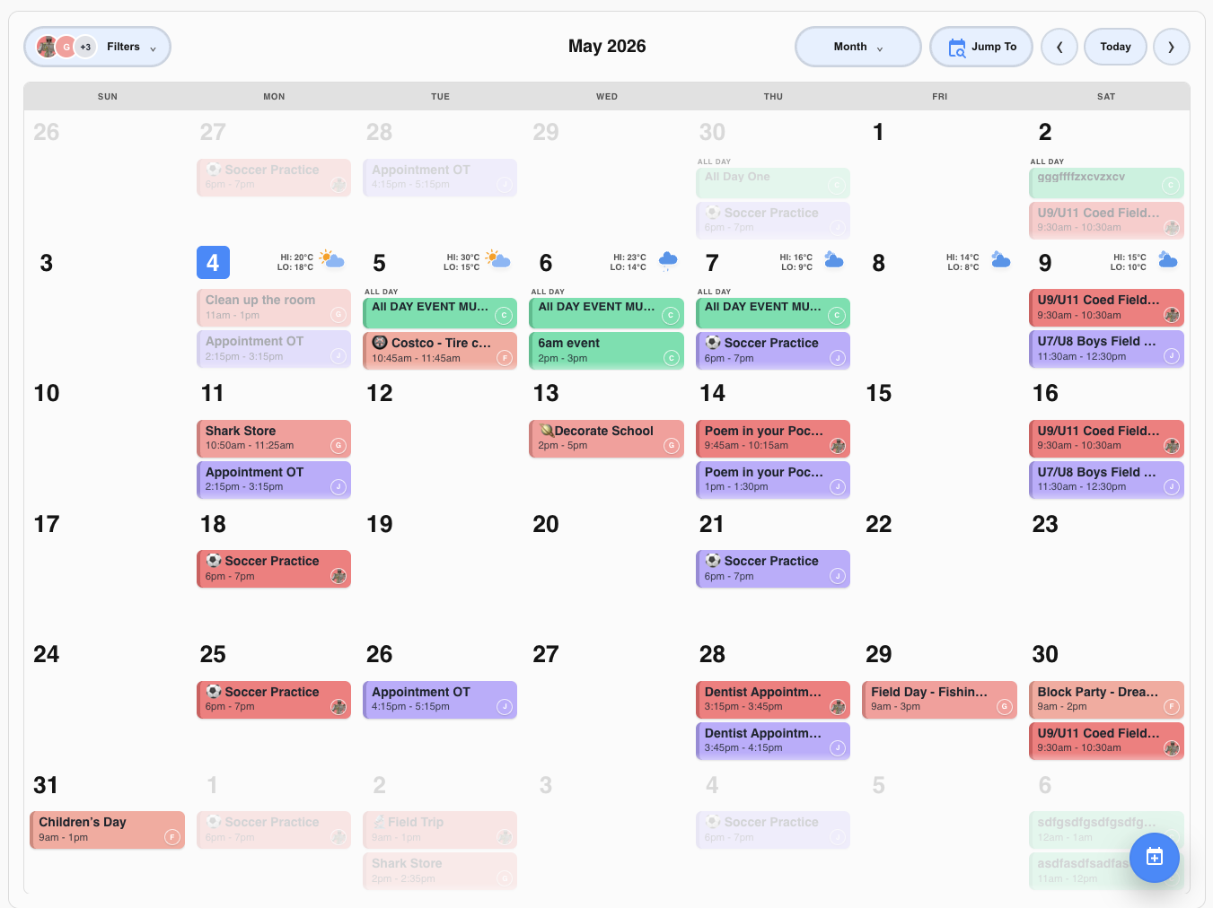

Screenshots
I have started using this integration and its working great!
1 minor improvement that I would appreciate is the ability to reduce the even size on the month view.

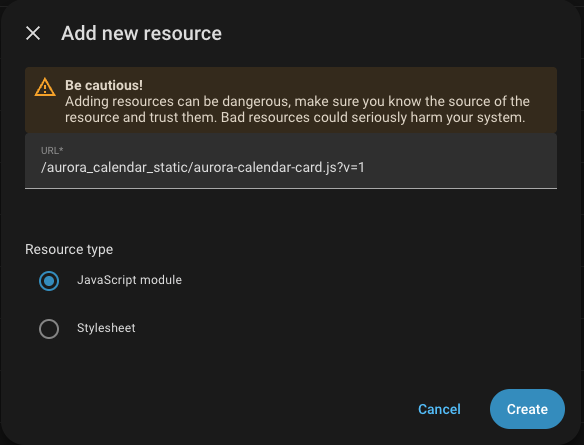

I am getting this error.
I have the integration installed and it was working, but now it's not.
Custom element doesn't exist: aurora-calendar-card.
Hi @rsissons,
UPDATE: I have fixed the issue and deployed a new version "v 0.1.1" that fixes this problem (so you won't need to follow the workaround), let me know if you're having any other issue updating the integration.
I think I saw the issue recently after an update in my home kiosk and started looking into this right after, I will submit a ticket on the Github repo to include the fix as soon as possible, if you encounter any other issue please feel free to submit an issue on the link below:
In the meantime, i think there is a workaround:
  1. Navigate to Settings -> Dashboards
  2. Click on the Right Three dotted Menu, then on "Resources"
  3. This takes you to the Resources screen, click on the "+Add Resource" floating button.
  4. On the pup-up screen please add this line:
    /aurora_calendar_static/aurora-calendar-card.js?v=1
  5. Resource Type must be "JavaScript Module"
Try clearing cache after this and let me know if this helped.
